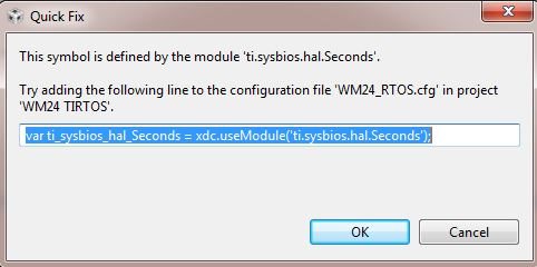

However when compiling this error is generated:
Undefined reference to 'ti_sysbios_hal_Seconds_get__E' in file ./main.obj     .xdchelp    /WM24 TIRTOS       C/C++ Problem
The compiler suggests this a fix:
var ti_sysbios_hal_Seconds = xdc.useModule('ti.sysbios.hal.Seconds');
Adding this to the project lets the program compile, but the unit lockups in Seconds_set at the clock enable bit. Understandable because this hardware is not used on this unit.

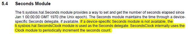

    The SupportProxy field for Seconds module is documented here. Section 5.4 of the user guide also has some info on the Seconds module and how SecondsClock can be used as the delegate for this module.
    You can only add the Seconds module through the GUI (XGCONF) but I dont think there is a way to change the SupportProxy in the GUI.
