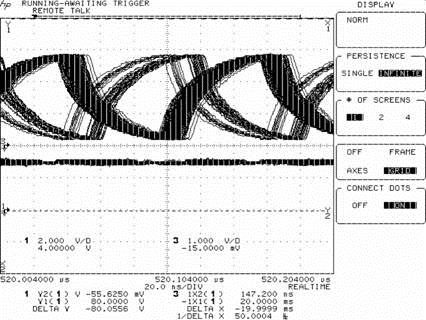

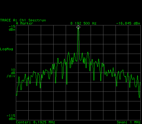

I had a clock jitter problem on C5517 McBSP.
I measured the clock out pin and found the clock phase noise was worse than clock in.
How can I improve the clock jitter?

  • Yes, I measured CLKOUT pin and compared with CLKIN.
  • The input clk is 16.384MHz to C5517 and the PLL settings lists below.
    MOV #0101111100000000b, port(#PMR) ; PLL mult = (0x5F00 / 256) + 1 = 96
    MOV #0000000000000011b, port(#PICR) ; PLL reference divider = 4, 16.384MHz / 4 = 4.096Mhz Ref freq
    MOV #0000000000000000b, port(#PODCR); Output divider = 0 (OD = 0 + 1 = 1, OD2 = (0 + 1) * 2 = 2, OUTDIV2BY = 0)
    MOV #0000000000000000b, port(#PCR) ; Normal operating mode
    After that, I generated the 8.192MHz from McBSP_CLKX and found the phase noise was bad.
    So, I measured C5517 General Purpose EVM's CLKOUT on HEADER3 to check it hardware or software issue.

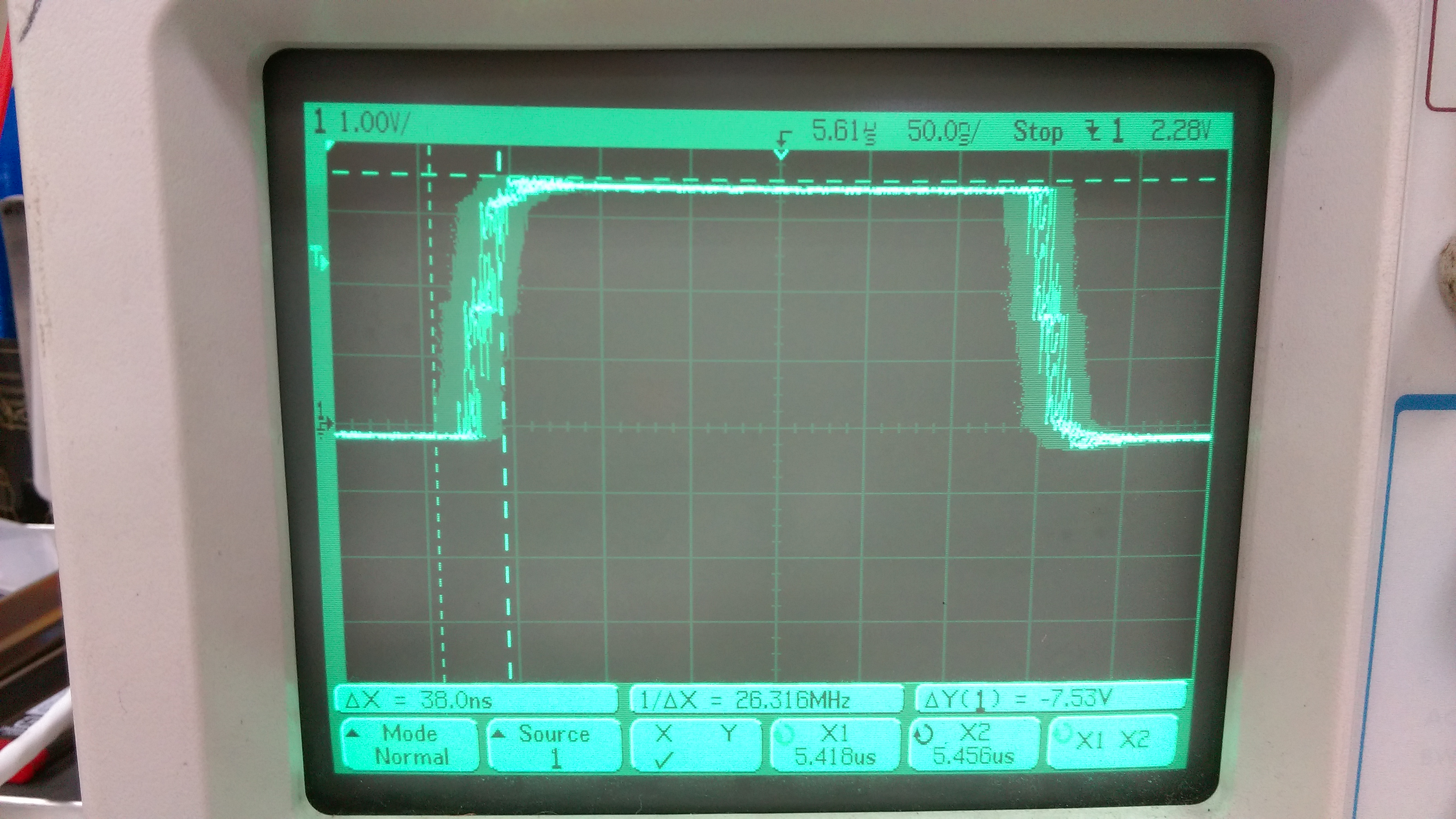

    I have some problem.
    I use C5517-EVM with McBSP_Master_AIC3204_48kbps_POLL
    I captured the waveform of McBSP_CLKX (L10) as below.
