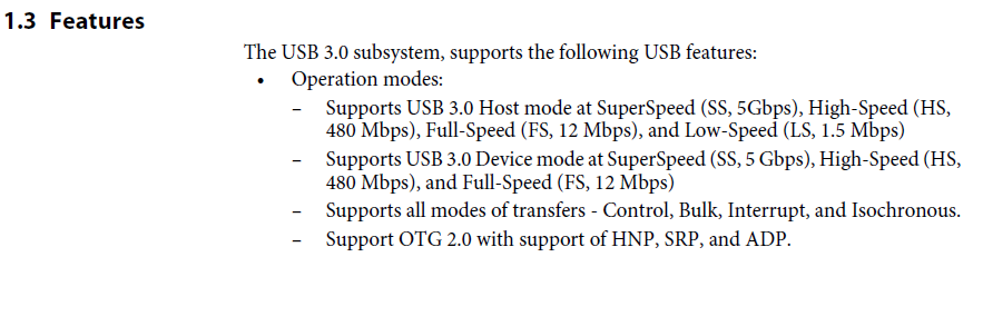

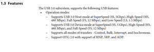

    I checked the USB3.0 User Guide for Keystone2(spruhj7.pdf), it showed that "Support OTG 2.0".
    Thus it seems that Keystone2 support OTG feature. What do you mean that "Please know OTG feature will not be supported in Keystone 2 devices".
    Kaka
  • Kaka-san
    We will be removing this bullet from the next rev of the user guide. There is no software support available for OTG.
