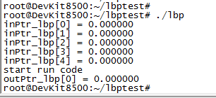

My Question :
for my question, I want put the svm_weight value into inPtr_lbp (in red word) ,
because I wnat put them to DSP code and calculate,
but when I printf the value (in blue word), it will show zero, not the floating point,
so In the DSP code, the svm_weight value will show zero,
How should I do for this problem , or any example that I can reference,
Thank you~

    I can not see memory allocation for the inPtr_lbp array in your code example. Could you try for example to define the inPtr_lbp as array:
    XDAS_Int8 inPtr_lbp[5];
    instead of
    XDAS_Int8 *inPtr_lbp;
    or to make memory allocation by malloc(...) command.
    The second issue is that the XDAS_Int8 type is integer but you try to set floating point values.
    BR
    Tsvetolin Shulev
  • Dear Tsvetolin Shulev,
    thank you for your suggest, and I follow your suggest,
    but it not matter, and I attach my integral code ,

    And the result:
    And for your second suggest,
    does there any type can put my floating point ?
    Or other method ?
    Thank you~
    Steven
