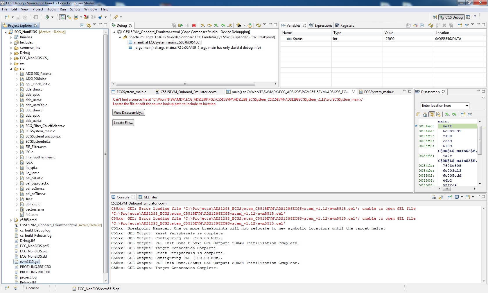

I compilled ECG_NonBIOS.pjt file and after i loaded the program of ECG_.NonBIOS.out.
But i couldn't get the right signal.
It says "Can't find a source file at "C:\WorkTI\SW\MDK\ECG_ADS1298\PG2\C5515EVM".
Regards.
  • From you first picture, you are having problem during CCS connect. What Gel file are you using? You can use the C5515EVM_Onboard_Emulator.ccxml that comes in CSL 3.04. It uses the evm5515.gel in the same CSL folder.
    Regards.
    Yes i used the C5515EVM_Onboard_Emulator.ccxml that comes in CSL 3.04 and evm5515.gel in the same csl folder. I connected the target and after building all, , loaded the program. But there was a warning said,

    And an error says
    Can't find a source file at "C:\WorkTI\SW\MDK\ECG_ADS1298\PG2\C5515EVM\ADS1298_ECGSystem_C5515EVM\ADS1298ECGSystem_v1.12\src/ECGSystem_main.c"
    Locate the file or edit the source lookup path to include its location.
    I couldn't find what is the problem?
