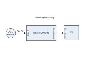

For  video application samples can you suggest me how to run a sample video code, I have a sample application for "video loopback" (file attached )which was given along with the spectrum Digital Davinci EVM6446 (EVM) demo board, I am trying to run this code but I get a jumping video output ( of camera capture)at the TV.
My set Up : A CCTV camera(PAL standard) output is connected to s-video input port of the EVM, Composite video output of the EVM is connected to composite input of the TV. also same setup, but EVM input is at the the composite port we are getting a blank screen (no video seen)(block diagram attached).
CCS : Code Composer Studio 5.5.0 (for Windows XP PC)
Emulator: spectrum Digital XDS560v2 LC traveler Emulator
Please suggest me how to execute and get the loop-back video correctly or please suggest execution of any sample application/ example of video application.
