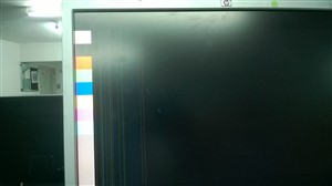

  • i am using HP LP2465 lcd monitor screen , From board am rediresting to hdmi using board ti8148.
    Iam getting 1/8 th of screen for 1920 X1080 .
    regards,
    karthik
  • hi,
    Iam getting HDMI I2C LOW ? getting only 1/8 of screen is getting displayed with iMage.
    karthik
  • hi ,
    iam getting HDMI L2C low ? Iam getting image on 1/8 th of the screen.
    Can you suggest me any fix ?
    Can you enable the venc to produce color bar test pattern and see the color bar once hdmi module is loaded ? (To enable HDMI pattern you need to enable #define ENABLE_VENC_COLORBAR_TEST  1 in hdmi.c) by default when the module is loaded you need to see color bar pattern on hdmi 1080p60.)
    --Prabhakar Lad
