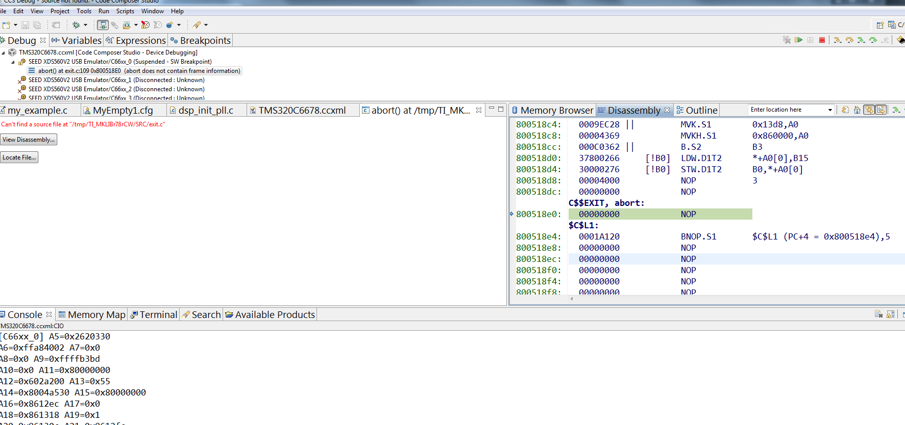

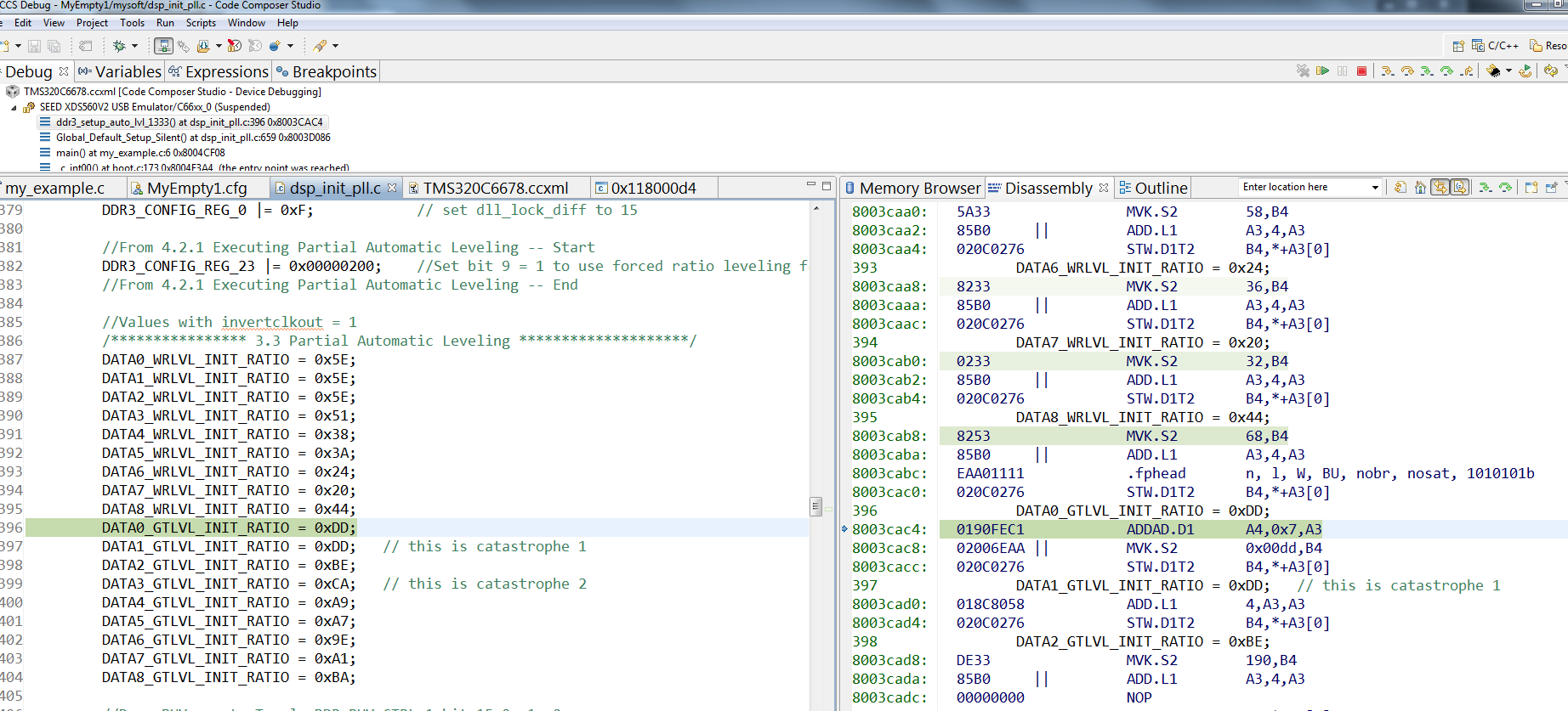

I have problem with DDR3 initialization. I am going to create application to TMS320C6678. As I understand I should to initialize DDR3 in my project. I should also use to my application Multicore Navigator and other modules. If I use Gel file to initialize - I receive error initialize
it last run string - next
If I don't use Gel file - I can not download the program using the emulator.
If I disconnect this cfg file - I can not use QMSS and CPPI modules, but initialize DDR3 and PLL working.
Where is my error?

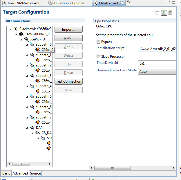

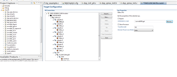

  • Hi Oleg,
    Have you given the gel file path correctly Initialization script in (Target Configuration file) .ccxml-> Advanced -> C66xx_0?

    But I should create application run to customer board without emulator. I should initialize PLL, DDR3 without gel file in C code. Or am I wrong?
        Oleg
  • Hi Oleg,
    yes if you don't use the GEL file your code needs to initialize the DDR3 interface, etc ...
