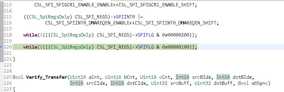

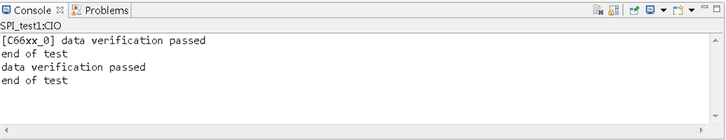

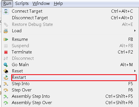

I can run once pass at first time, but I can't run this test again (Run->Restart). It would get struck on
void Setup_SPI (void)
   while(!(((CSL_SpiRegsOvly) CSL_SPI_REGS)->SPIFLG & 0x00000100));  <== Struck here.

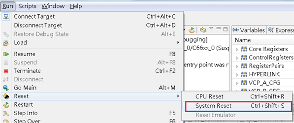

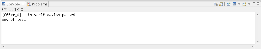

If I reset the system (Run->Reset->System Reset + Run->Restart), the test would pass.
How can I fix it? Thanks you.
