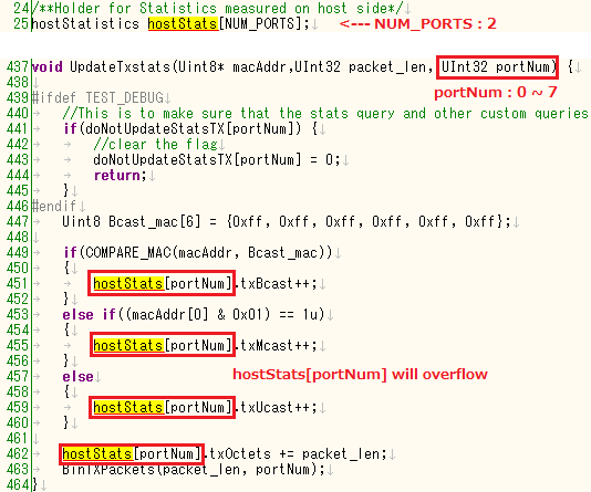

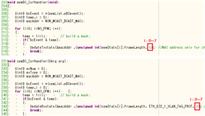

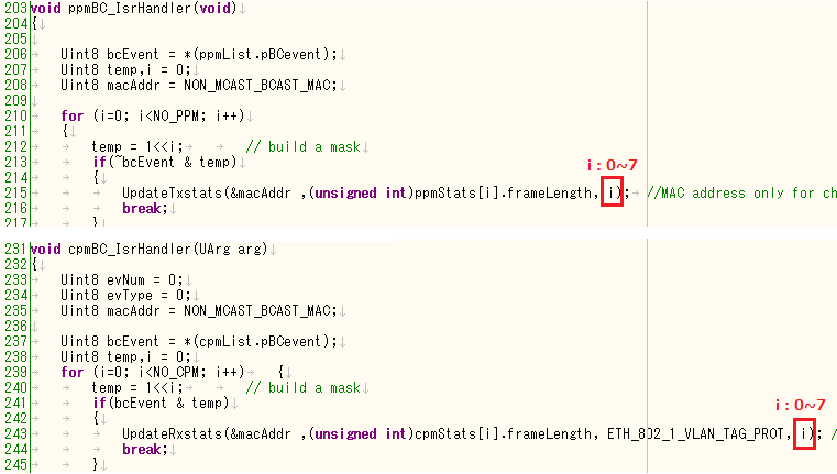

I am evaluating ISDK v1.1.0.5.
In the following source code, variable "i" is set from 0 to 7.
It may occur illegal access inside functions UpdateTxstats(), UpdateRxstats().
Since NUM_PORTS is defined as 2, we think hostStats[portNum] will overflow.
Question)
Is my understanding right?
Do you have any workaround?
Best regards, RY
