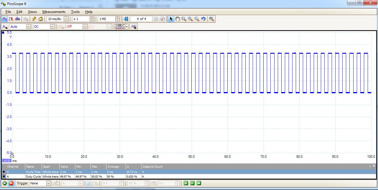

It looks like I found a problem with the 1ms DMTimer. If you clear the overflow flag too early (DMTIMER_1MS_TISR_OVF_IT_FLAG), it looks like the interrupt is fired twice. If a insert a small loop after the timer interrupt is cleared, everything works perfectly as expected!

Osciloscope:
A) Bad Duty Cycle:
B) Good Duty Cycle (with the delay):

    // Looks like there is a synchronization issue in hardware: when the timer interrupt is cleared, and the interrupt handler returns too early, the interrupt is fired twice.
    volatile uint32_t delayCounter = 0U;
    while(delayCounter < 50U) {
        ++delayCounter;
