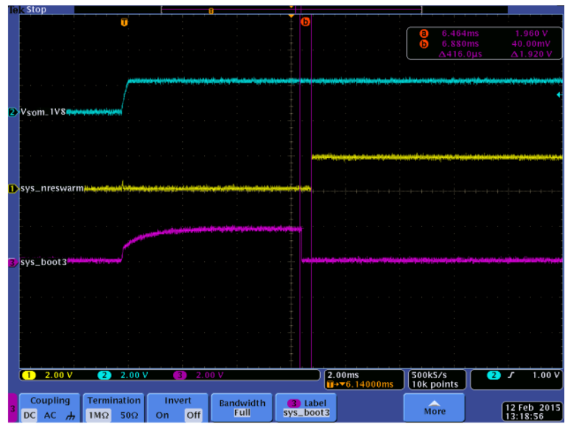

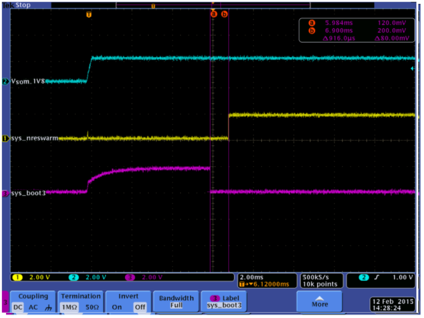

On the DM3730 processor the sys_boot signals are shared with LCD data signals.  Since the LCD is not yet powered until after the sys_boot signals are latched this is putting a load on the sys_boot signals at reset.  This load through the ESD diodes is causing the sys_boot signals to be incorrectly latched.  We can alter the load by changing the bulk capacitance on the LCD I/O voltage rail.  However, we don't know when the sys_boot signals are being latched with respect to the SYS_nRESWARM signal.  My questions are the following.
When are the SYS_BOOT signals being latched by the processor?  I did find information in the documentation is that they are latched “following a power-on reset”.  Are they latched on the rising edge of SYS_nRESWARM?  Or afterwards?  If afterwards, what is the minimum and maximum time they are latched?
