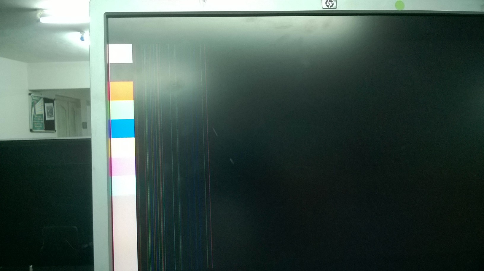

HDMI out put is showing 1/8 part on the monitor and remaining part as garbage lines.(ti8148 and linux-04.01.00.07)
I am using the ti8148 evm based customized board and linux-04.01.00.07. I have inserted the following modules and started the firmware as below
insmod syslink.ko
firmware_loader 1 dm814x_hdvicp.xem3 start
firmware_loader 2 dm814x_hdvpss.xem3 start
insmod vpss.ko sbufaddr=0xBFB00000 mode=hdmi:1080p-60 i2c_mode=0
insmod ti81xxfb.ko vram=0:24M,1:16M,2:6M
insmod ti81xxvo.ko
insmod ti81xxhdmi.ko
fbset -xres 480 -yres 272 -vxres 480 -vyres 272
and run the following script it was playing the video but only 1/8 part of the monitor is getting displayed properly and remaining part is showing as some lines

    This output which you are seeing on the display is not from the pipeline.
    You shall see a video not a colorbar.
    I believe that about this issue there was a suggestions here:
    e2e.ti.com/.../399423
    e2e.ti.com/.../399139
    What it the display timing ?
    How the display is connected to the board?
    Margarita
  • Hi Margarita,
    As you mentioned it was playing video only, I attached that image to explain how much of the monitor screen is getting displayed. Suggestions link which you mentioned does not have any useful information as if I don't connect hdmi cable how can video be transferred to the hdmi monitor.
    I am suspecting if any code changes required in the Linux kernel related to linux-04.01.00.07/drivers/video/ti81xx/ti81xxhdmi/edid.c
    We are using hdmi to dvi cable to connect dvi connector monitor.
    Sudheer.
    Are you able to reproduce the issue on EVM?
    Or provide me steps how I can reproduce it on DM8148EVM.
    Margarita
  • Hello Sudheer,
    Please see this thread:
    e2e.ti.com/.../528114
    "HDMI is not compatible with DVI. Infact DVI output can be shown on HDMI TV since HDMI is backwards compatible with DVI. But HDMI output cant be shown on DVI, Most of the monitors support DVI and not HDMI."
    Could try to connect a HDMI to check are you will observe the issue. I assume that you will not.
    Margarita
