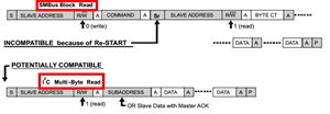

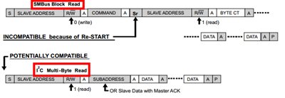

   How I can add  Add SMBus emulation for block read  for i2c-omap.
     I use Dm8148' i2c1 to control a smbus device(USB2514BI) .
    USB2514I  can just use "Smbus block read and write mode" to access, But I find i2c-omap driver not support "Smbus Block Read".
   How I can make omap-i2c support  "Smbus Block Read"?
