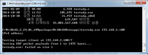

C:\ti\ndk_2_24_01_18\packages\ti\ndk\winapps  testudp.exe
my pc ip setting  :192.168.2.200
             gateway : 192.168.2.101
I was conneced to my evm board to Swich , also i was conneced to my pc  to swich.

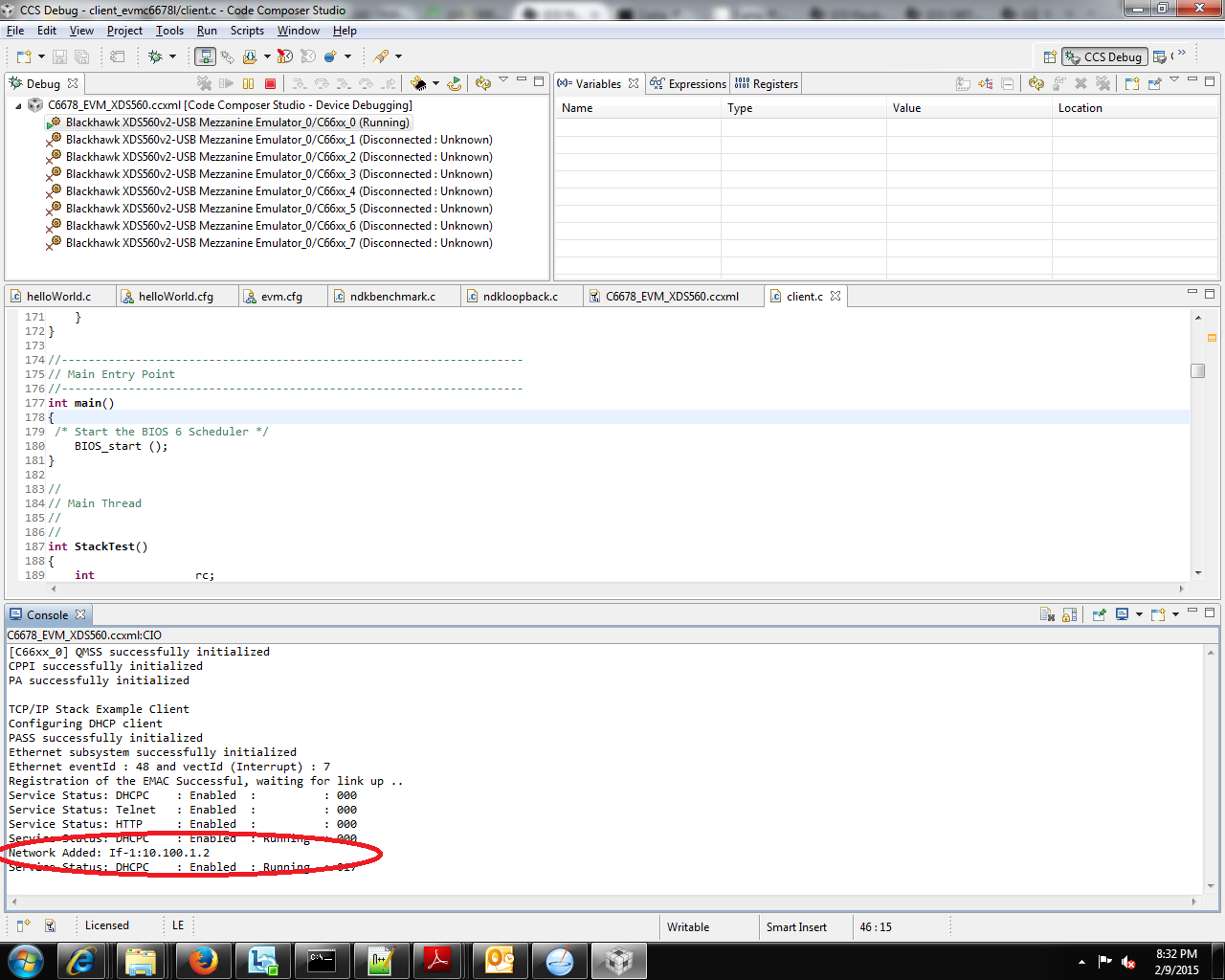

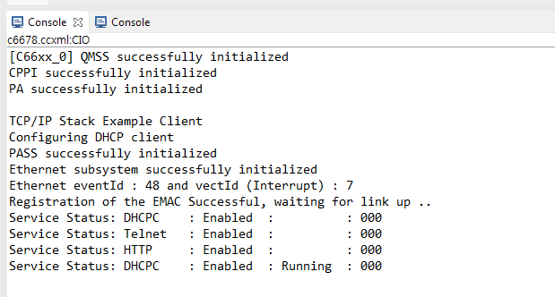

first I runned client_evnc7778l.out from ccs
after that , second I runned testudp.exe from my cmd window
But I failed my test
This is CCS Screen

2. What the problem on my test?

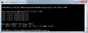

3. not able to ping from my pc
   ping 192.168.2.100
  That,s means : <100% Loss>
