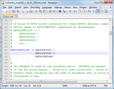

I modified the tiros.mak as follows:
When I try to build the MSP430Ware driverlib and TI-RTOS driver libraries, I receive the following errors:

  • Hi Blair,
    Can you check your <tirtos install dir>/tirtos.mak file and verify you are using the correct compiler version?
    CCS_BUILD ?= true
    DEFAULT_INSTALLATION_DIR      ?= c:/ti
    ti.targets.msp430.elf.MSP430X ?= $(DEFAULT_INSTALLATION_DIR)/ccsv6/tools/compiler/msp430_4.3.3
    Installed compilers are found in <CCS install dir>\ccsv6\tools\compiler
    -- Emmanuel
  • Hi Emmanuel,
    I checked the file and compiler was incorrect. The original file expected v4.3.1, but v4.3.3 is installed on my system. I updated the tirtos.mak file to match and was able to run gmake!
    Thank you for your help!
