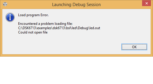

Hi Ankit,
Is really that .out file available in mentioned location ?
Rebuild the project and try.

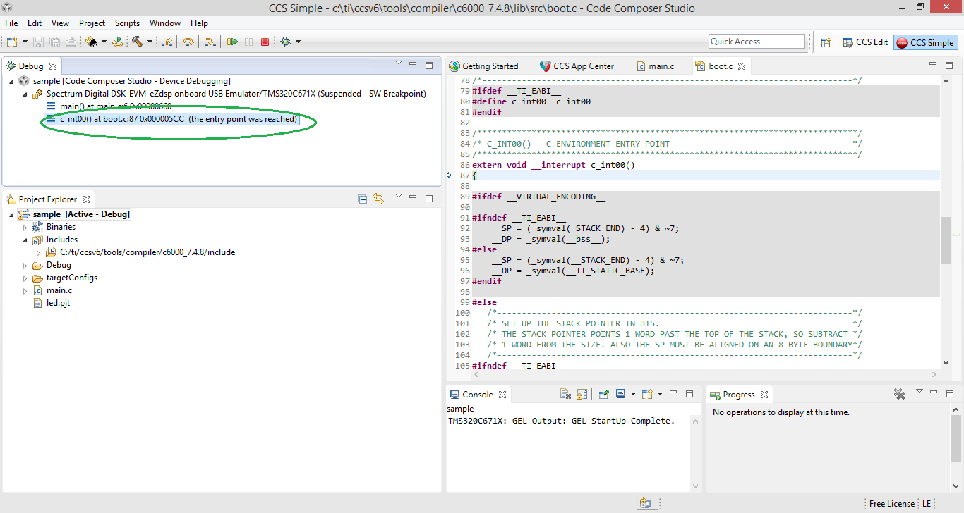

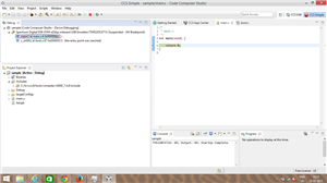

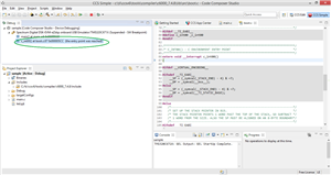

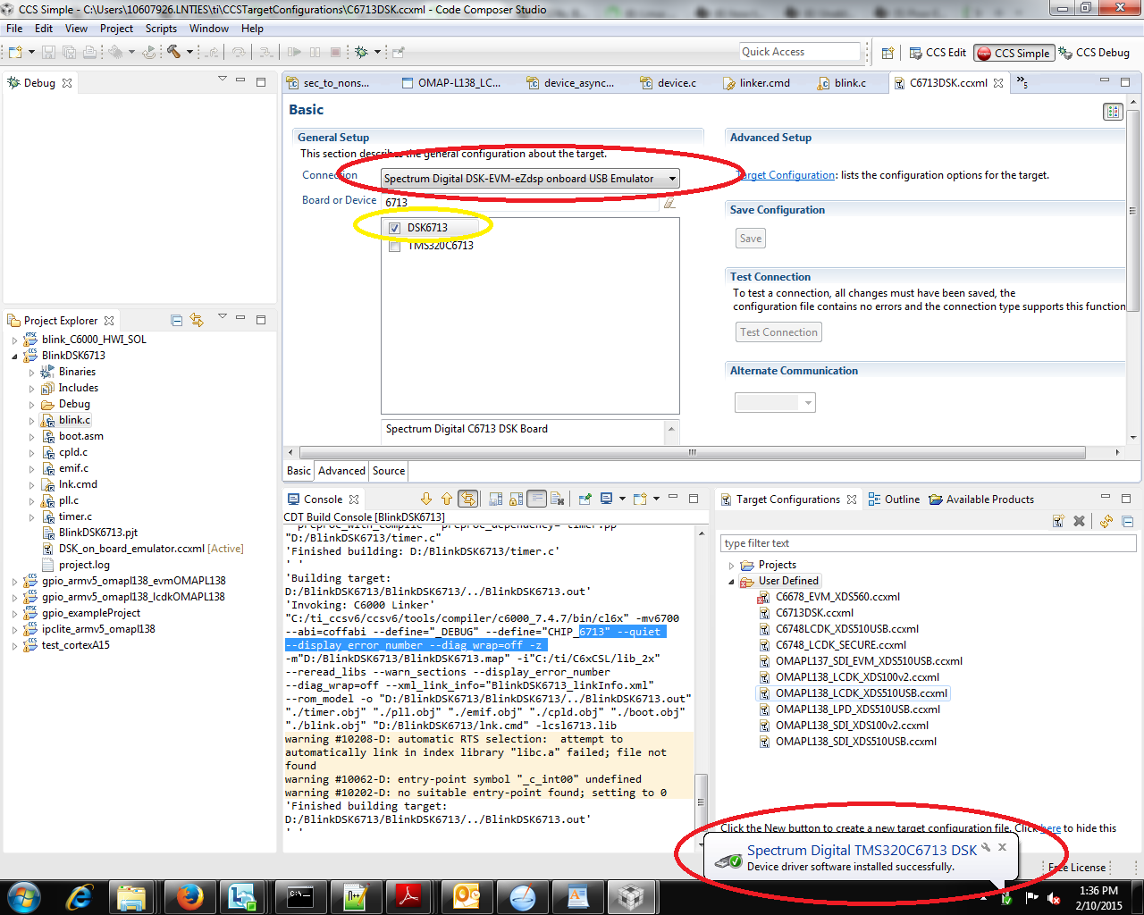

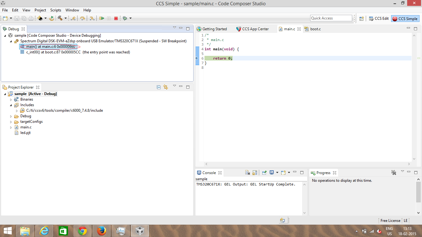

1.when i created a new project and added "led.pjt"
from examples, above 2 errors were generated.
2.And for the BIOS issue i have installed bios version 5.
3.when i try to import ccs project directly from dsk6713 examples it comes up error that install "
c6000 v8 compiler", but when i installed it, and then at the time of building the program it comes with a error that "compiler v7.48 will be compatible"
