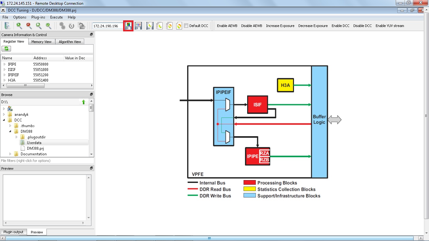

After running the CBB RDK Usecase,
we are getting ISS register seting as below using command
root@xyz:/opt/cbb# devmem2 0x5C011080  # ISIF_CGAMMAWD
/dev/mem opened.
Memory mapped at address 0x40303000.
Value at address 0x5C011080 (0x40303080): 0x7708
root@xyz:/opt/cbb# devmem2 0x5C011004 #ISIF_MODESET
/dev/mem opened.
Memory mapped at address 0x402a7000.
Value at address 0x5C011004 (0x402a7004): 0xC
ISIF_CGAMMAWD         0x7708  supporting 12-bit data from sensor
ISIF_MODESET          0x0C    No data shift.

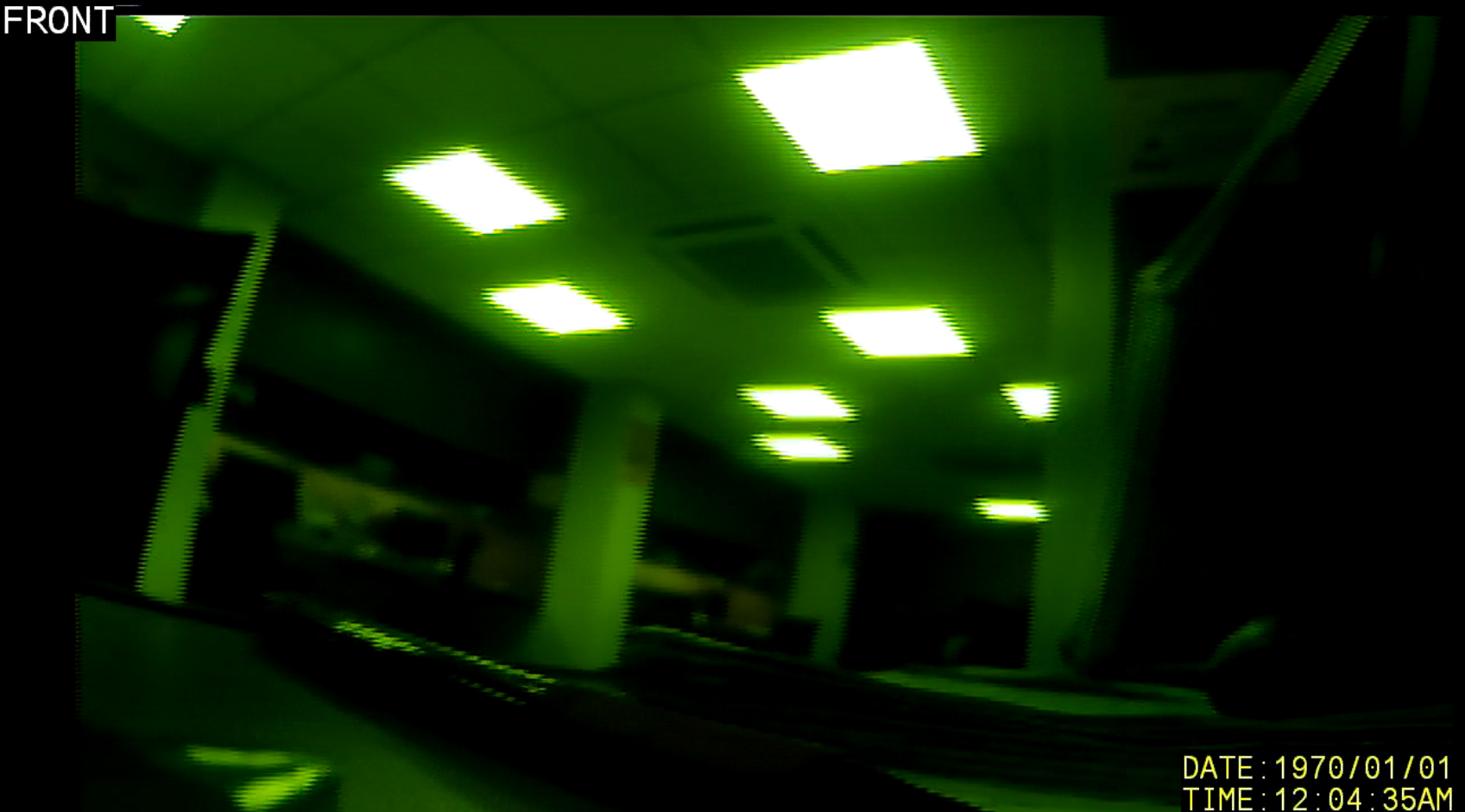

According to TI's ISS_TRM by this configuration it should be able to capture RAW-12 bit, but
we are receiving video with Green color background as shown below snapshot:

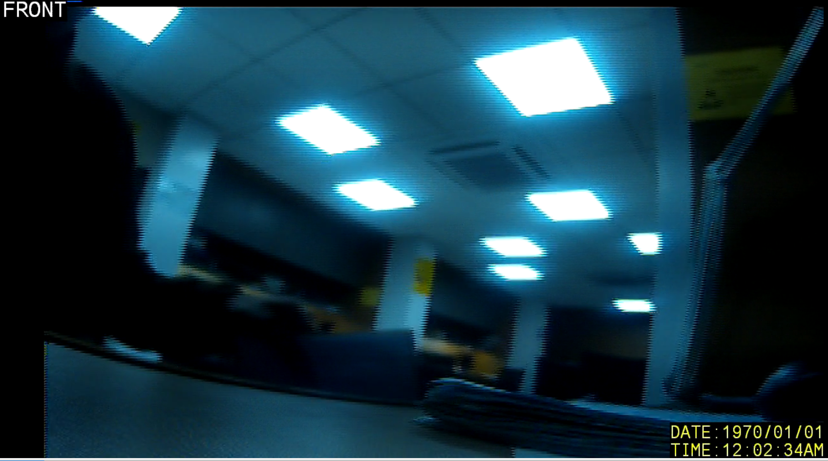

Now when we disabled auto white balance we are receiving image shown as below:
Anyone knows the problem or possible solution??
