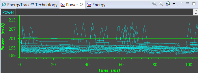

Hello e2e community,
I've been experiencing some strange behavior with Energy Trace in my TI-RTOS project. I'm working on a low power sensor platform that reads some sensors and transmits the data via an XBee module. I'm using the MSP430FR5969 Wolverine launchpad. This is my first project using the Wolverine and TI-RTOS, so I may just be making a simple beginner mistake somewhere. I use the Clock module to periodically call a function which posts a semaphore to unblock/enable the associated Task function. The problem is that while running, it seems that every time the semaphore posts, the graph in Energy Trace "resets" and starts over. I'm unable to get an estimate of enegry consumption and CPU state because Energy Trace only shows data until the first semaphore before beginning again at time=0. After a few seconds the graph looks like a mess because the traces are drawn over top one another. Has anyone else experienced this sort of behavior? This has been bothering me for a while now and I've been unable to find anything like this elsewhere on e2e. I've posted my MAIN.cfg and .c file below. Thanks in advance for any help or suggestions.
