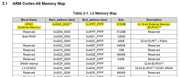

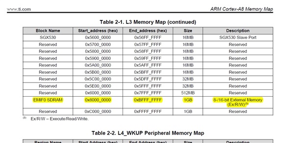

Hi, I'm just getting started with the ICE V2 EVM and am having trouble finding all of the documentation. The few questions that I have right now are:
1) What's the memory map for the ICE V2? The board has SDRAM and FLASH but I have no idea where they are in the address map
2) The TRM spruh73 section 26 says the ROM code initializes at 2000 0000 but table 2-1 L3 memory map states Boot ROM is 4000 0000 and 2000 0000 is reserved. Why the discrepancy?
