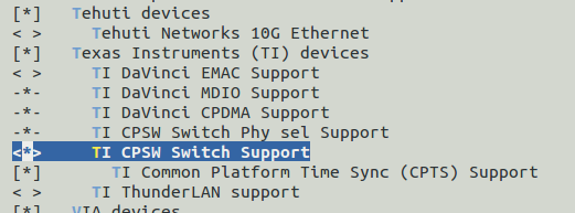

I'm trying to bring the Ethernet interface up on our AM3358 custom board in Linux and I'm having some trouble. We want to use the CPSW in dual emac mode. I'm having to write my own PHY driver. We're using the TI kernel from the Sitara 07.00.00.00 SDK.
According to AM335x CPSW (Ethernet) Driver's Guide, there is an option to enable dual emac mode in the kernel configuration. However, the option is not there:
emac0 is connected to a PHY at address 1 (emac 1 is PHY 0). I'm only trying to get emac0/PHY1 to work at the moment.
