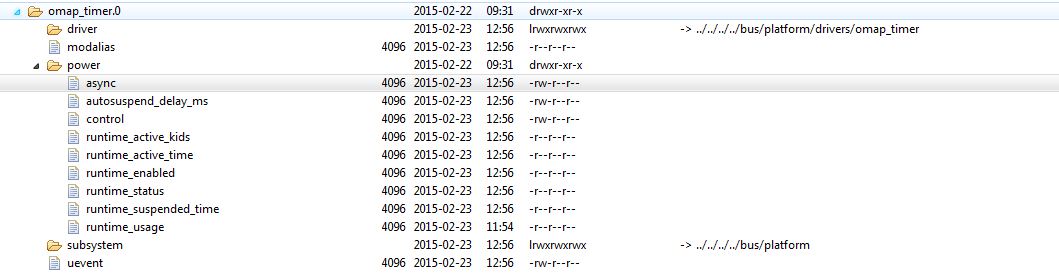

                                  I got some relevant information regarding driver usage  from this link  . But how can i access timers in BeagleBone white from user side (using JNI).
I am working Android JellyBean4.1.2 (Linux kernal version 3.2) .
Is it possible by "cat"  any of the file in the following image ?
I need to count the pulses arriving in timer pin.
How can i do it  ?
  • Hi Don,
    I do not think the timer exposes anything in the /sys folder.
    The omap_timer seems to be only reachable from the kernel, this means that you would need to write a driver for exporting this to the userland.
    From what I understand, you could also take a look at the ecap (which is made for event counting), but there is currently no driver for counting yet, only pwm mode.
