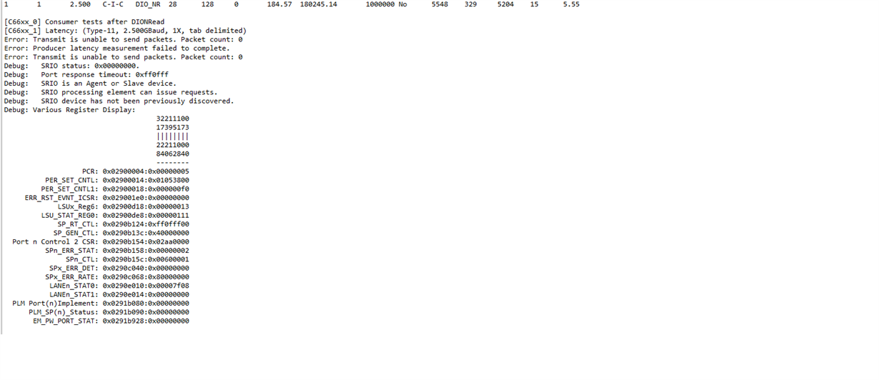

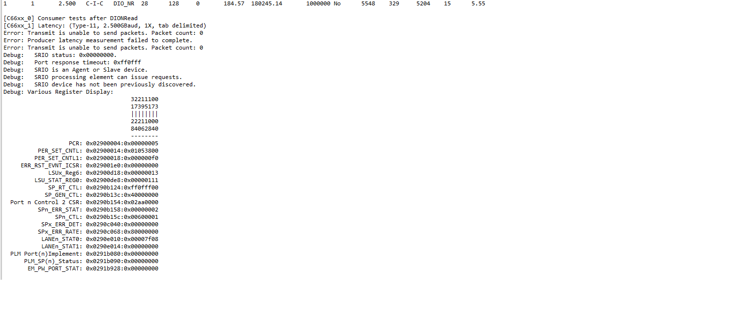

SRIO communication between two c6678 dsps through switch
We have four c6678 DSPs(with SRIO port 0 of each dsp only) connected to a switch(cps1616) on a custom board. Our aim is to establish communication between any two dsp, say DSP0 and DSP1 through the switch. Our desired configuration is 1x and 2.5Gbps speed. We tried running loopbackDioIsr project on DSPs first in loopback mode and they were successful . We made the necessary changes to run loopbackDioIsr project in normal mode by changing mode from loopback to normal and swapped the source and destination ID in second dsp, DSP1.  We made routing table in switch through switch registers. We followed this thread:  We also made sure that before any transfer occur, respective ports in switch are in OK state. The problem is that, in srio switch as soon as transfer from DSPs starts, the port shows output error and input error. We tried to run the code snippet(maintenanceReadReg) given in above thread by Brandy but it returned error that "ISR didn't happen within set time". We contacted IDT too for this error and they are suggesting us to do routing through maintenance packets but I have little idea about how to do it.
I have the following questions:
1. Is there any register which stores number of packets sent through DSP? So that we
can confirm that some packets have been sent out of DSP.
2. How can we configure switch through maintenance packets?
Some of the register values after we run above program in normal mode are:
  rio_sp_err_stat= 0x00020002
  rio_sp_ctl     = 0x00600001
  rio_err_det    = 0x01000000
  rio_sp_err_det = 0x00000001
  rio_sp_lm_resp = 0x80000005
  rio_comp_tag   = 0x00000000
  Please let us know if you need to any other register values.

  • Hi Ganapathi,
    Thanks for your reply. I tried to run SRIO_TputBenchmarkingTestProject on DSP in loopback mode. It seems there is some problem with transmission of packets. I have attached screenshot of output here. Sorry for the formatting.
    Have you modified any function on this example?
    Have you referred SRIO_Benchmarking_Example_Code_Guide for build and run the SRIO example as loopback mode?
    I have tested the SRIO example project (SRIO_TputBenchmarkingTestProject) on EVM C6678 in loopback mode. It is working fine. Please find the attached test log.

    SRIO_TputBenchmarkingTestProject is working fine in loopback mode. Actually in our board we are using 156.25MHz as ref clock but in srio_device_tput.c file ref clk is directly assigned 312.5MHz. But it seems that above project is working properly in loopback mode without making this change. When we tried to connect our DSP to srio switch(cps1616) then without changing this value, we were not able to get "port ok" on switch(We were getting input error on port). Now when we changed it(ref clk value in srio_device_tput.c), errors also mitigated.
    We are trying to use C-S-C configuration, but as soon as DSP is starting to send packets, the switch port is showing input error. We ensured that routing table is as per our requirement. From counter registers in switch we found that it received only 1 packet that too it dropped. The same thing happened when we tried to run diolsrloopback project in normal mode.
