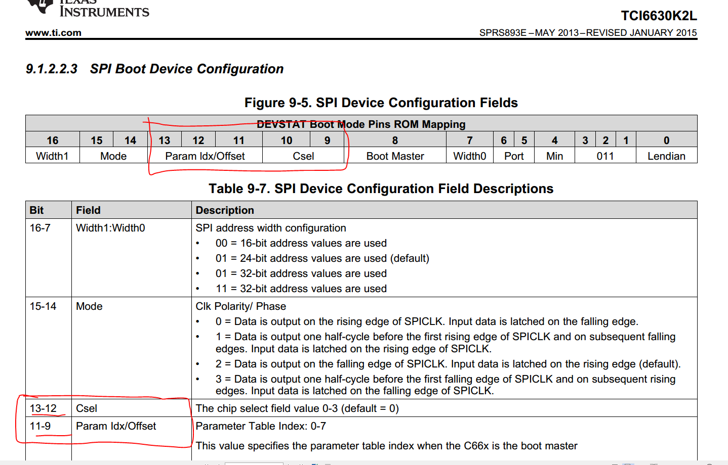

TCI6630K2L SPI device config fields typo ?
Other Parts Discussed in Thread: TCI6630K2L
Hi All,
in the TCI6630K2L D/S at section SPI Boot Device Configuration, the figure 9-5 contradicts the  table 9-7, especially about  bits Csel and the  Param Idx/Offset.
Could you please clarify which one is right ?
Picture here below as illustration.
