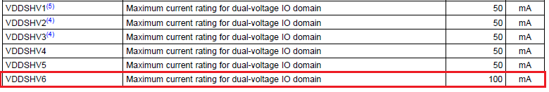

  • This would depend on the VDDSHVx voltage used - 1.8V or 3.3V. Please check also Table 5-10 in the AM335X Datasheet Rev. G for maximum current ratings on power supplies.
  • Hi Biser,
    Thank you for the information.
    Please let me clarify this, as there is no specification of
    maximum current for a pin in the datasheet.
    Regarding the maximum current in "Table 5-10",
    do you mean to say "Maximum current rating for dual-voltage IO domain"?
    The SPI0  belongs to VDDSHV6 power domain(100mA) & the voltage used is 3.3V.
    So can I assume the SPI over current should not exceed 100mA?
    And if we use 22 ohm series resistors on the SPI bus,
    the over-current may cross 150mA during short-circuit....
    So we may have to use atleast 33ohm resistors? to avoid the damage of the SPI pins.
    Please let me know if the above understanding is correct?

  • I suppose you are talking about 4mA total current. Input current on the flash SPI pins should be in the range of microamps. SPI is not a multi-host interface, precautions should have been taken at the design phase. As for SPI0 pins, they can source/sink up to 6mA. You can try with something like 680 Ohm serial resistors (3.3V / 6mA = 550 Ohm).

  • These IOs are able to source/sink more current than the AM335x device was designed to source or sink. That is why your product design must limit the current of all external loads to less than 6mA of sink/source current. These IOs are designed to source/sink LVCOMS loads which are small capacitive loads with a small amount of DC leakage. In some cases, there may be additional pull-up or pull-down resistors that present additional DC load. The total DC load shall always be less than 6mA.
    For example, if operating the IO at the maximum potential of 3.465 volts, the DC load to ground must be greater than 577.5 ohms.
    These IO were not designed to support a use case where they are shorted to VDD or VSS. The way you are trying to connect more than one processor directly to a single memory device is not a good design practice. Using series current limiting resistors as a way to protect the devices when may be a viable solution. However, there may be side effects. These resistors will slow transitions, which could cause the resultant signals to violate SPI timing parameters. If the signals have additional DC loads like pull-up/pull-down resistors, the DC voltage drop across the series resistors could cause the signals to violate Vih min and Vil max limits of respective input buffers.
