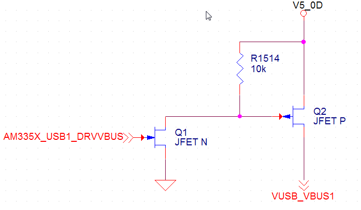

We are developing a custom board based on the AM335x processor. We use linux kernel 3.14.33 with a custom device tree !
Every thing works as excepted, except the USB1 host port. This port is connected permanently to a 3 ports USB hub.
If I connect an usb drive (memory stick) before the startup (on the port1 of the hub), the drive is detected and everything works !

But if I remove the usb key (I got a usb 2-1.1: USB disconnect, device number 3) and plug it again, nothing appends...
This is very strange... USB1_VBUS is always powered with a VCC 5V
I noticed another thing... if I do a echo on > /sys/bus/usb/devices/usb2/power/control and plug the key again, the device is detected (only one time)
Has some body an idea ?
