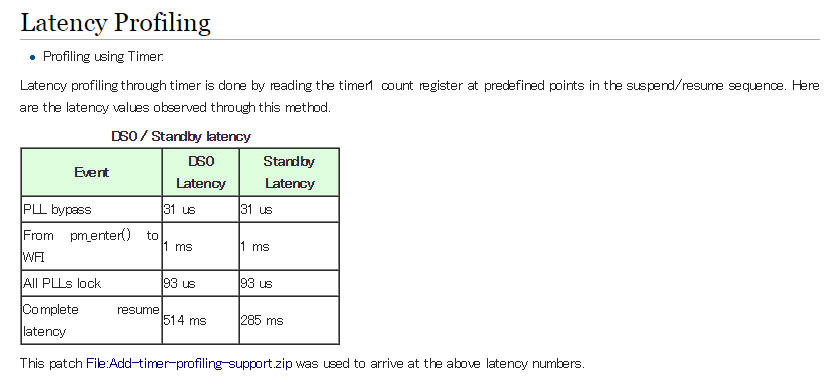

Latency Profiling of Am335x is indicated to this Page.
processors.wiki.ti.com/.../AM335x_Power_Management_Standby_User's_Guide
Is there Latency Profiling of Am437x similarly?
Regards, Hidetaka.

Please check section 2.20.1.2 of this wiki: http://processors.wiki.ti.com/index.php/Sitara_Linux_SDK_Kernel_Performance_Guide
