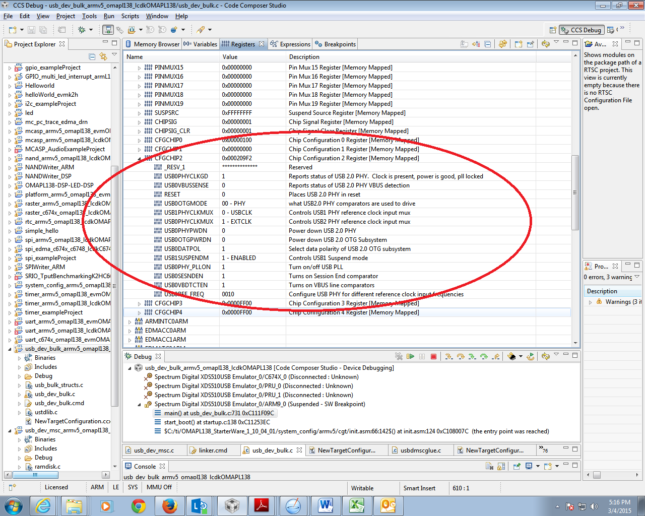

  • Hi Samuel,
    I have tested once again today, the USB_dev_bulk  example on OMAPL138 LCDK board. It works as expected. I have connected to a PC and able to recognize it as a BULK device. Captured the CFGCHIP2 when the processor act as a device. Please refer to the details below and compare it with the values of each field of the CFGCHIP2.

  • No bulk device show up in the device manager,  I added some code in usbdenum.c before calling the USBReset function to make my CFGCHIP2 match yours.
    unsigned int  reg = 0;
    reg = HWREG(g_USBInstance[ulIndex].uiPHYConfigRegAddr);
    reg |= CFGCHIP2_USB1SUSPENDM;
    reg |= CFGCHIP2_SESENDEN;
    reg |= CFGCHIP2_VBDTCTEN;
    reg |= CFGCHIP2_NO_OVERRIDE;
    HWREG(g_USBInstance[ulIndex].uiPHYConfigRegAddr) = reg;
    After that my CFGCHIP2 = 100110100111110010 (0x269F2)
    your CFGCHIP2 =               100000100111110010 (0x209F2)
    my CFGCHIP2[13-14] always get set to 11 (0x3), yours is 00 (0x0)
    It makes no difference if I use CFGCHIP2_NO_OVERRIDE , CFGCHIP2_FORCE_HOST or CFGCHIP2_FORCE_DEVICE. it always gets set back to 11 (0x3).

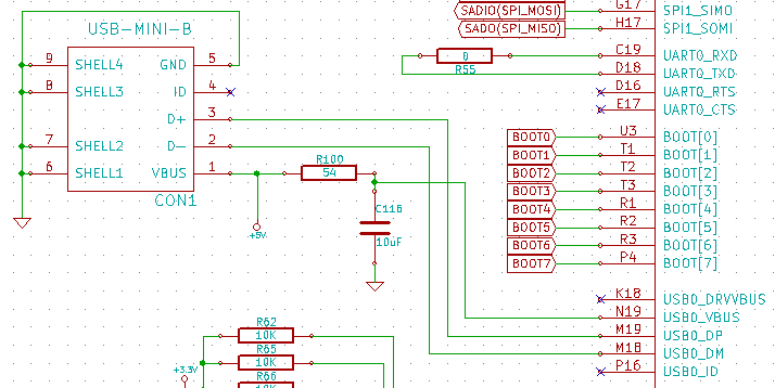

    Here is my USB connection schematic: Note the VBUS resistor (R100) is easily  removable/changeable
    Thanks for your help.
  • Hello Samuel,
    Can you try isolating VBUS and USB0_VBUS by removing R100 and connect +5V directly to USB0_VBUS ? Hope you have +5V power rail in your custom board.
    Also try probing the USB0_VBUS pin for correct voltage level.
    Senthil

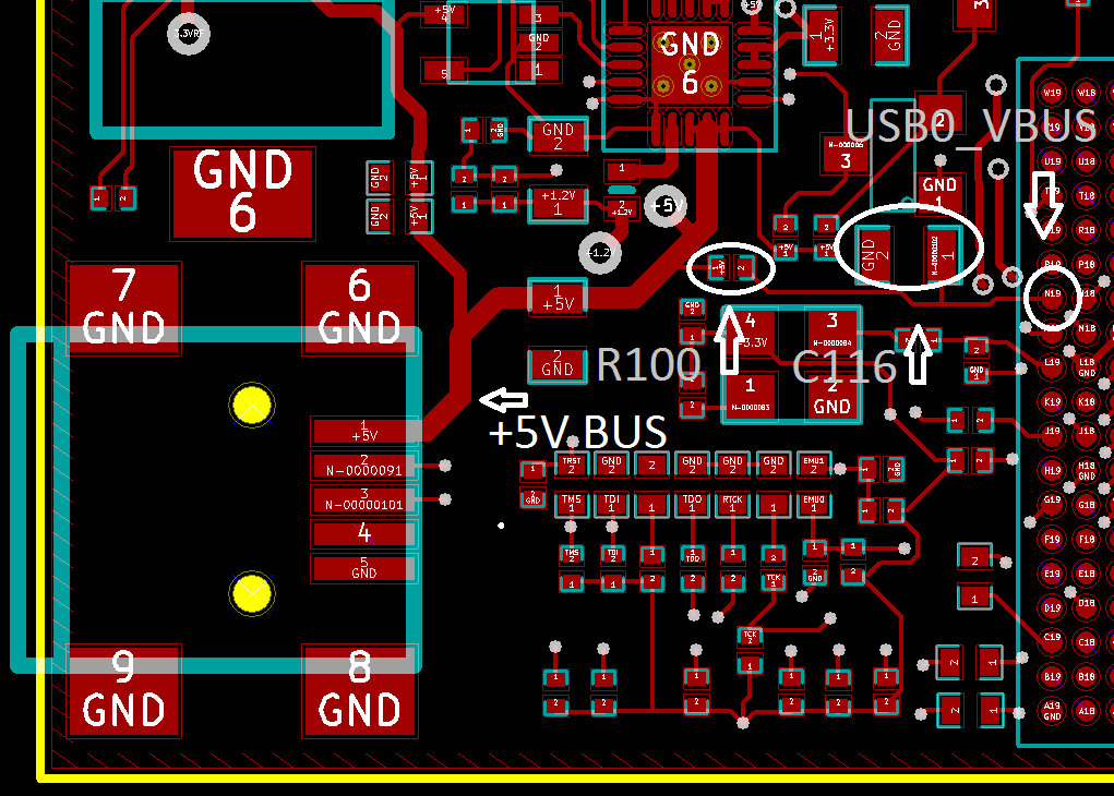

  • My board is USB powered. Here is a shot of the top layer of my board to show how the USB0_VBUS is connected to the incoming +5V power.
    If I connect R100 the CFGCHIP2[16] (USB0VBUSSENSE) bit comes on and goes of if I disconnect R100.

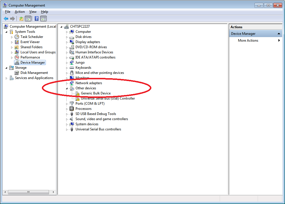

  • I replaced the TMS320C6748 with the OMAP-L138.
    If I manually set the USB registers my device shows up as an unrecognized device
    HWREG(0x01C14184) &= 0xFFFFDFFF; // Force USB device
    HWREG(0x01C14184) |= 0x00000002; // 0010b => 24MHz Input Source
    I am not receiving any interrupts.
  • I put in some debugging code to see what gets called in the USB driver.

    It looks like like it hits
    case USB_STATE_STATUS:
    without doing anything then we received a reset from the host. Is this normal?
  • This obviously isn't enumerating correctly.
    This is the output of TDD
    Information for device USB\Vendor_1CBE_Product_0003:
    Connection Information:
    Connection status: Device connected
    Device actual bus speed: High
    Device is hub: No
    Device adress: 0x0002
    Current configuration value: 0x00
    Number of open pipes: 0
    Device Descriptor:
    0x12	bLength
    0x01	bDescriptorType
    0x0110	bcdUSB
    0xFF	bDeviceClass   (Vendor specific)
    0x00	bDeviceSubClass
    0x00	bDeviceProtocol
    0x40	bMaxPacketSize0   (64 Bytes)
    0x1CBE	idVendor
    0x0003	idProduct
    0x0100	bcdDevice
    0x01	iManufacturer
    0x02	iProduct
    0x03	iSerialNumber
    0x01	bNumConfigurations
    Device Qualifier Descriptor is not available. Error code: 0x0000001F
    Configuration descriptor and all subsequent descriptors are not available. Error code: 0x0000001F
    String Descriptor Table
    Index  LANGID  String
    0x00   0x0000
    0xEE   0x0000  Request failed with 0x0000001F
    Connection path for device:
    Standard Enhanced PCI to USB Host Controller
    Root Hub
    Brought to you by TDD v1.83.0, Mar  7 2014, 14:22:05
