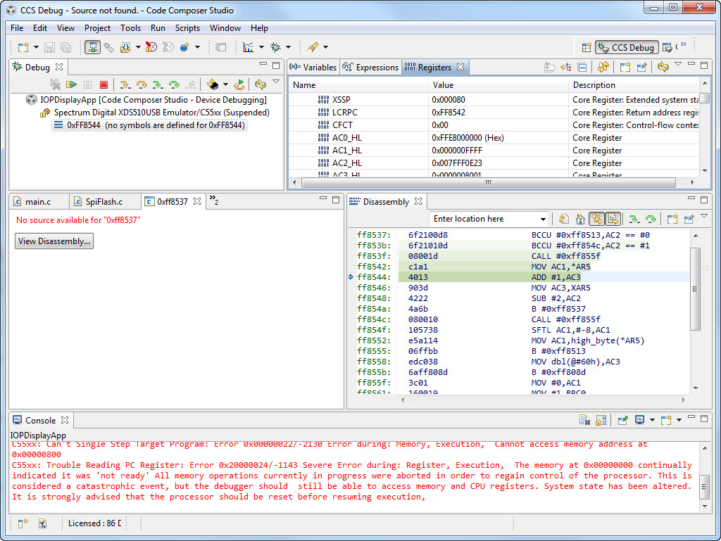

         I was wondering if you have been able to come up with any suggestions or sample code for simulating a hardware reset from software.  I have been trying the approach of "jumping" to the boot ROM address of 0x00ff8000 with no success.  I seem to end up in the weeds.  I am using the following c code:
    entryPoint = 0xff8000;
    ((void (*) (void)) entryPoint)();
    It seems to jump to the Boot ROM code, but then goes off into the weeds. I get the following message from the debugger:
    C55xx: Trouble Removing Breakpoint with the Action "Continue or Finish Stepping" at 0x457f: Error 0x00000008/-1066 Error during: Break Point, Cannot set/verify breakpoint at 0x0000457F
    C55xx: Can't Single Step Target Program: Error 0x00000022/-2130 Error during: Memory, Execution, Cannot access memory address at 0x00000800
    There are likely registers I need to clear or set up before I make the jump, but not sure what they are.
    Below is  a screen shot of the debugger output:
    Any suggestions would be appreciated.
    Stephen
  • Stephen,
    If a hardware reset can be simulated by software, then would it be a software reset :-) Anyway, I am thinking that this error is caused by CCS accessing registers by default, can the c code be executed without CCS? I am really out of idea.
    Regards.
  • Hi Steve,
         We have not been successful in trying to implement a reset strictly from software that would cause the boot ROM to execute. We have put that effort on the back burner for now (to be re-visited when time allows) due to schedule.  In the meantime, we have implemented a hardware/software solution to the problem.
    Thanks for your help.
    Stephen
