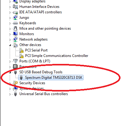

  • Able to see the DSKC6713 driver notification on your PC after powered up your DSKC6713 board ?
    If not, then you might get detect hardware with warning symbol like what I have for "PCI Serial port" and try to update the driver by using the following path.
    C:\ti\ccsv5\ccs_base\emulation\drivers
    Still if you face the same problem I would like to suggest to use latest CCS IDE version (CCSv5.5 or CCSv6)
    You need to provide the processor's family details for emulator dirver installation when you install CCS IDE on your PC.

    You are right, there is no driver for the device (warning symbol present) - postimg.org/.../nj2sxrznv
    When trying to manually update driver, I couldn't find any drivers (.inf files) in folder you mentioned (folder is present with some files inside, but no .inf file is there). I was trying to find it both in CCSv5.5 and CCSv6 (have them installed both). During installation, I picked C6000 single core DSPs (which should contain also TMS320C6713 I believe) - postimg.org/.../r8lzol7yt
    Additionally, there is a driver present on CD packed with starter kit (TMS320C6713), 6713.inf, but this one can't be installed (probably because of Windows 7 - 64bit) - postimg.org/.../i1a741v13
    I am currently trying to make it work using Windows XP running on virtual machine, I could succesfully finish connectivity test with 6713SDKDiag.exe, though I can't yet debug the device (testing it just a moment). Priority for me is to make it work on Win 7 but in case of necessity I will content myself with Win XP.

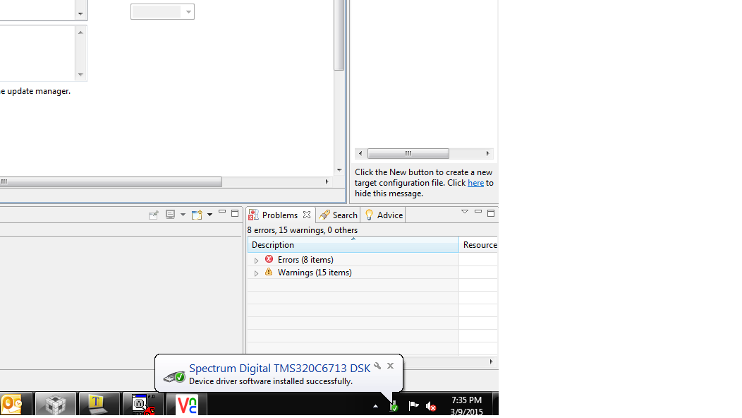

  • I hope, now you can debug your C6713DSK board with CCSv5.5 or CCSv6.
    Right now, I'm having CCSv5.5 and CCSv6 on my windows 7 machine (64bit)
    Please ask us if you have any doubts.
