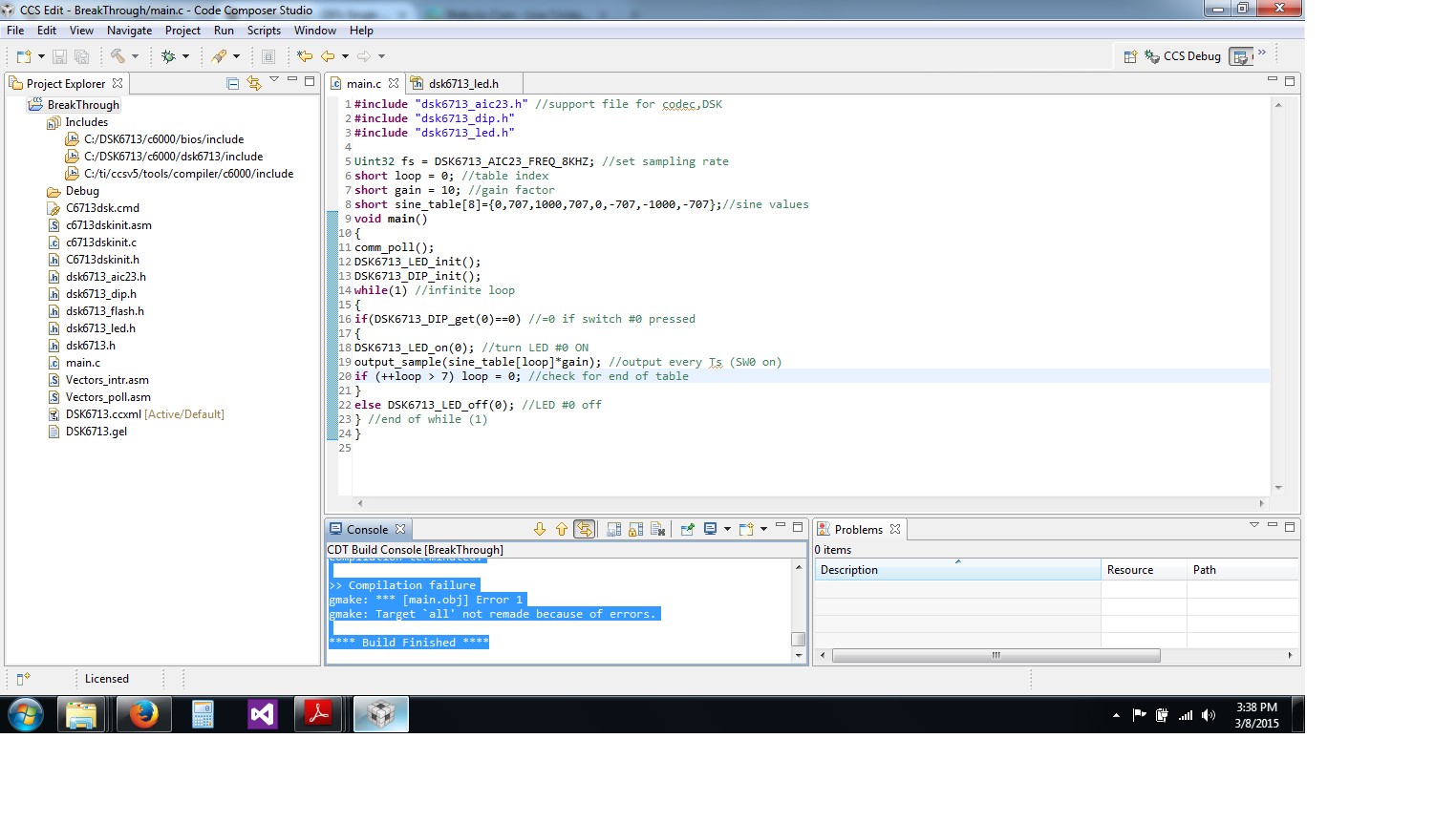

can somebody help me regarding ccs5.4 use for dsk6713 i have tried different manual but ends up in nothing.Here is the message i got after building first project,also there is a screen shot of my project as under.
**** Build of configuration Debug for project BreakThrough ****
C:\ti\ccsv5\utils\bin\gmake -k all
subdir_rules.mk:28: warning: overriding commands for target `c6713dskinit.obj'
subdir_rules.mk:21: warning: ignoring old commands for target `c6713dskinit.obj'
'Building file: ../Vectors_intr.asm'
'Invoking: C6000 Compiler'
"C:/ti/ccsv5/tools/compiler/c6000/bin/cl6x" -g --define=CHIP 6713 --include_path="C:/ti/ccsv5/tools/compiler/c6000/include" --include_path="C:/dsk6713/c6000/dsk6713/include" --include_path="C:/dsk6713/c6000/bios/include" --display_error_number --diag_warning=225 --mem_model:data=far --abi=coffabi --preproc_with_compile --preproc_dependency="Vectors_intr.pp"  "../Vectors_intr.asm"
[6713.]
>> WARNING: more than one source file is specified; preprocessor output will be generated for last file only
Fatal error #5: could not open source file "6713"
1 fatal error detected in the compilation of "6713".
Compilation terminated.
>> Compilation failure
gmake: *** [Vectors_intr.obj] Error 1
'Building file: ../Vectors_poll.asm'
"C:/ti/ccsv5/tools/compiler/c6000/bin/cl6x" -g --define=CHIP 6713 --include_path="C:/ti/ccsv5/tools/compiler/c6000/include" --include_path="C:/dsk6713/c6000/dsk6713/include" --include_path="C:/dsk6713/c6000/bios/include" --display_error_number --diag_warning=225 --mem_model:data=far --abi=coffabi --preproc_with_compile --preproc_dependency="Vectors_poll.pp"  "../Vectors_poll.asm"
[6713.]
>> Compilation failure
gmake: *** [Vectors_poll.obj] Error 1
'Building file: ../c6713dskinit.c'
"C:/ti/ccsv5/tools/compiler/c6000/bin/cl6x" -g --define=CHIP 6713 --include_path="C:/ti/ccsv5/tools/compiler/c6000/include" --include_path="C:/dsk6713/c6000/dsk6713/include" --include_path="C:/dsk6713/c6000/bios/include" --display_error_number --diag_warning=225 --mem_model:data=far --abi=coffabi --preproc_with_compile --preproc_dependency="c6713dskinit.pp"  "../c6713dskinit.c"
[6713.]
>> Compilation failure
gmake: *** [c6713dskinit.obj] Error 1
'Building file: ../main.c'
"C:/ti/ccsv5/tools/compiler/c6000/bin/cl6x" -g --define=CHIP 6713 --include_path="C:/ti/ccsv5/tools/compiler/c6000/include" --include_path="C:/dsk6713/c6000/dsk6713/include" --include_path="C:/dsk6713/c6000/bios/include" --display_error_number --diag_warning=225 --mem_model:data=far --abi=coffabi --preproc_with_compile --preproc_dependency="main.pp"  "../main.c"
[6713.]
>> Compilation failure
gmake: *** [main.obj] Error 1
gmake: Target `all' not remade because of errors.
**** Build Finished ****
