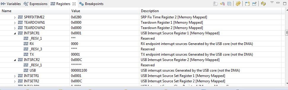

I have 2 interrupt sources in my project (for now) and i have some issues about serving both interrupts. I have a one hardware interrupt source and a usb module. When i run my code i noticed that my code never visits the usb_isr although usb interrupt source registers are set. However hardware intterupt is served and i didnt encounter any problems related to it.
You can see the status of usb interrupt registers below. As you can see interrupt flags for both endpoint 0 and endpoint 1 are set.
Below you can see how i enable the interrupts in initialization function. I use the IRQ_plug() and IRQ_enable() commands. I also set all used bits of USB Interrupt Mask Set Registers and their values are also below:

    Thanks for the reply. I checked the example you mentioned and see that they use the same csl functions for enabling USB interrupts (code below is taken from that example). I try to enable USB interrupts before making the necessary register modifications like in the example. However, my code still doest enter the usb_isr function that I wrote. When i put a break point in usb_isr nothing happens.
    If you can think of an another suggestion, i will be very happy since i dont understand the reason of this problem.
