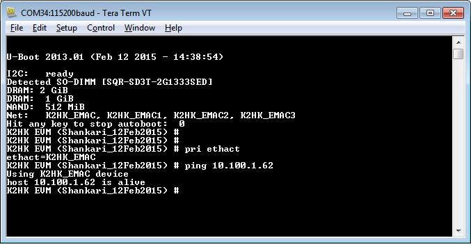

    By default, the environment variable, "ethact" is set to K2HK_EMAC. In K2H EVM there are two ethernet ports. please check in which ethernet port you have connected the K2H EVM. Port 0 or Port1. Accordingly you should set up the "ethact" variable like below
    >set ethact K2HK_EMAC1
    For your reference, the following is my bootlog. Observe that, in my bootlog, the ethact variable is set up to K2HK_EMAC.
    Please post your boot up log, we will help you set up the Ethernet connection on the K2H EVM.
