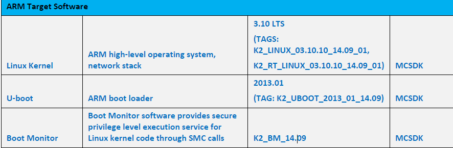

  • Hi Paul, We recommend you to use the latest MCSDK(03.01.01.04 Release notes) release tags mentioned in the release notes for usage.
    Thank you.
  • Tag K2_BM_14.09 corresponds to commit 4b0287a which exhibits the error I described. Commit 5137140 is the latest commit which doesn't exhibit the failure.
