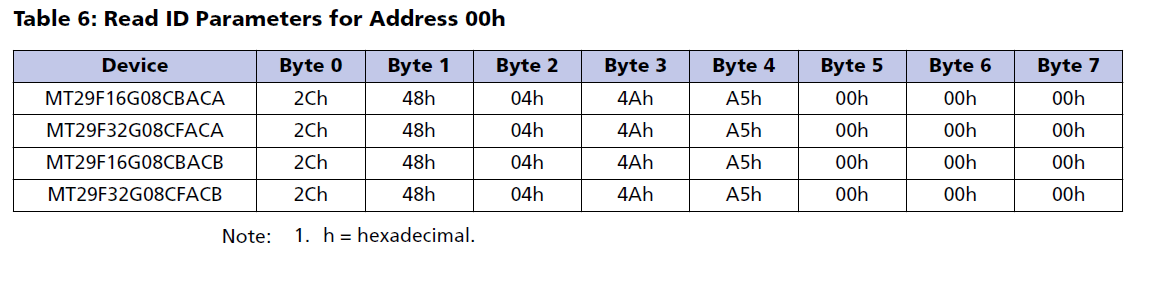

Does C5504 support the NAND boot by using the MLC NAND(MT29F16G08)?
If you have any question, please let me know.

I checked the NAND Flash which my customer would like to use.
The Device ID of this is "48h" as follow.
According to the user guide of bootloader, C5504 can support the NAND which is on "Table 2. Supported NAND Device IDs" Thus, the C5504 does not support this NAND flash.
Is my understanding correct?

Is not the problem in any kind of NAND(SLC NAND, MLC NAND, TLC NAND, OneNAND, PureNAND and so on) if it match with the Device ID of NAND Flash that has been described in Bootloader User Guide the C5504 supports?
