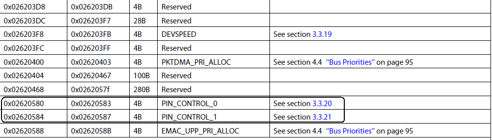

In pdk_C6657_1_1_2_6\packages\ti\csl\cslr_bootcfg.h, the register locations define is based on the struct "CSL_BootcfgRegs", but some register offsets are not same as the offsets indication in Device State Control Registers in latest C665x datasheet.
For example,CHIP_PIN_CONTROL_0 are located as below in CSL_BootcfgRegs, but the offset indication in datasheet is captured as below picture.
Which one should be followed?
