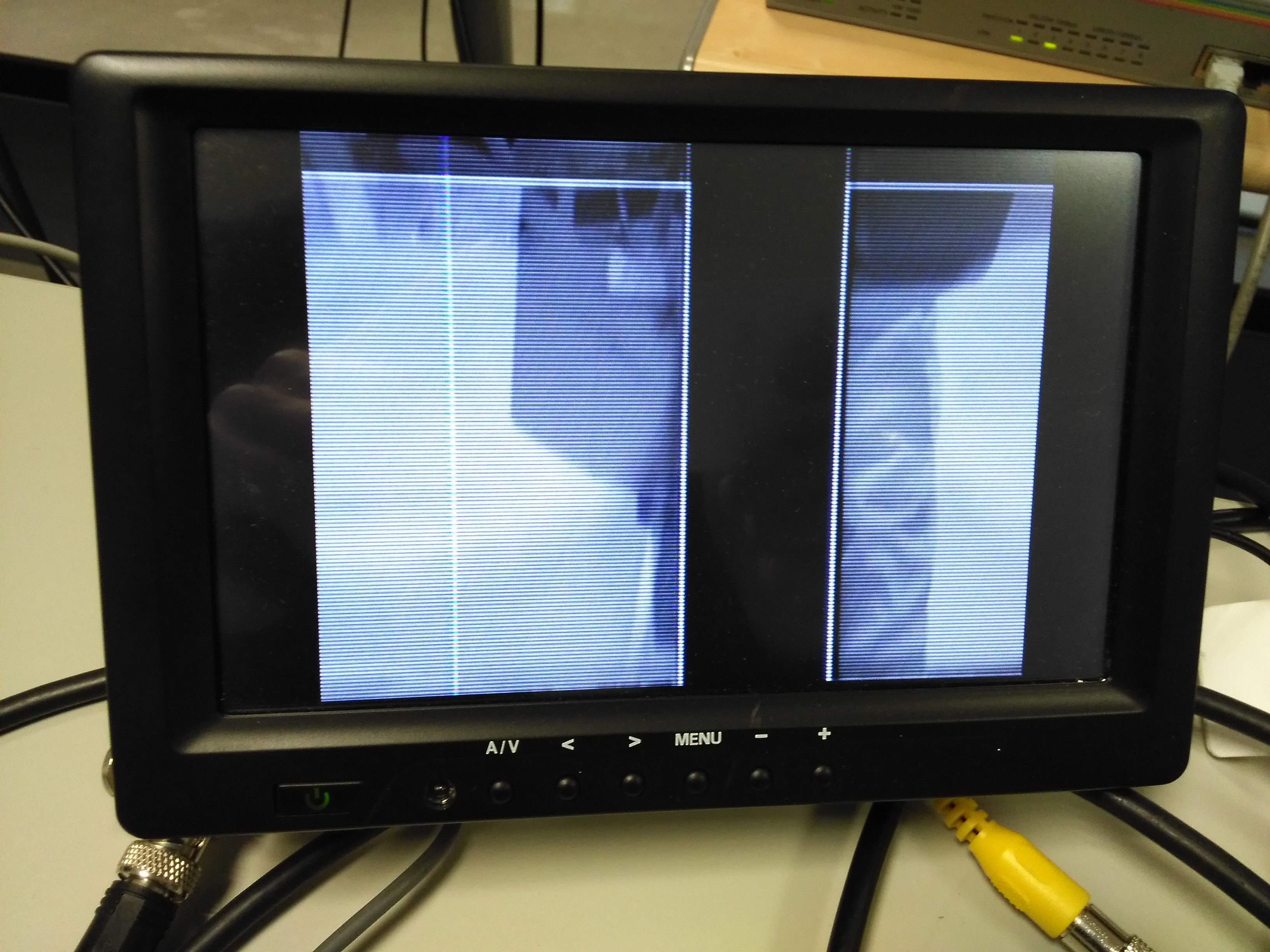

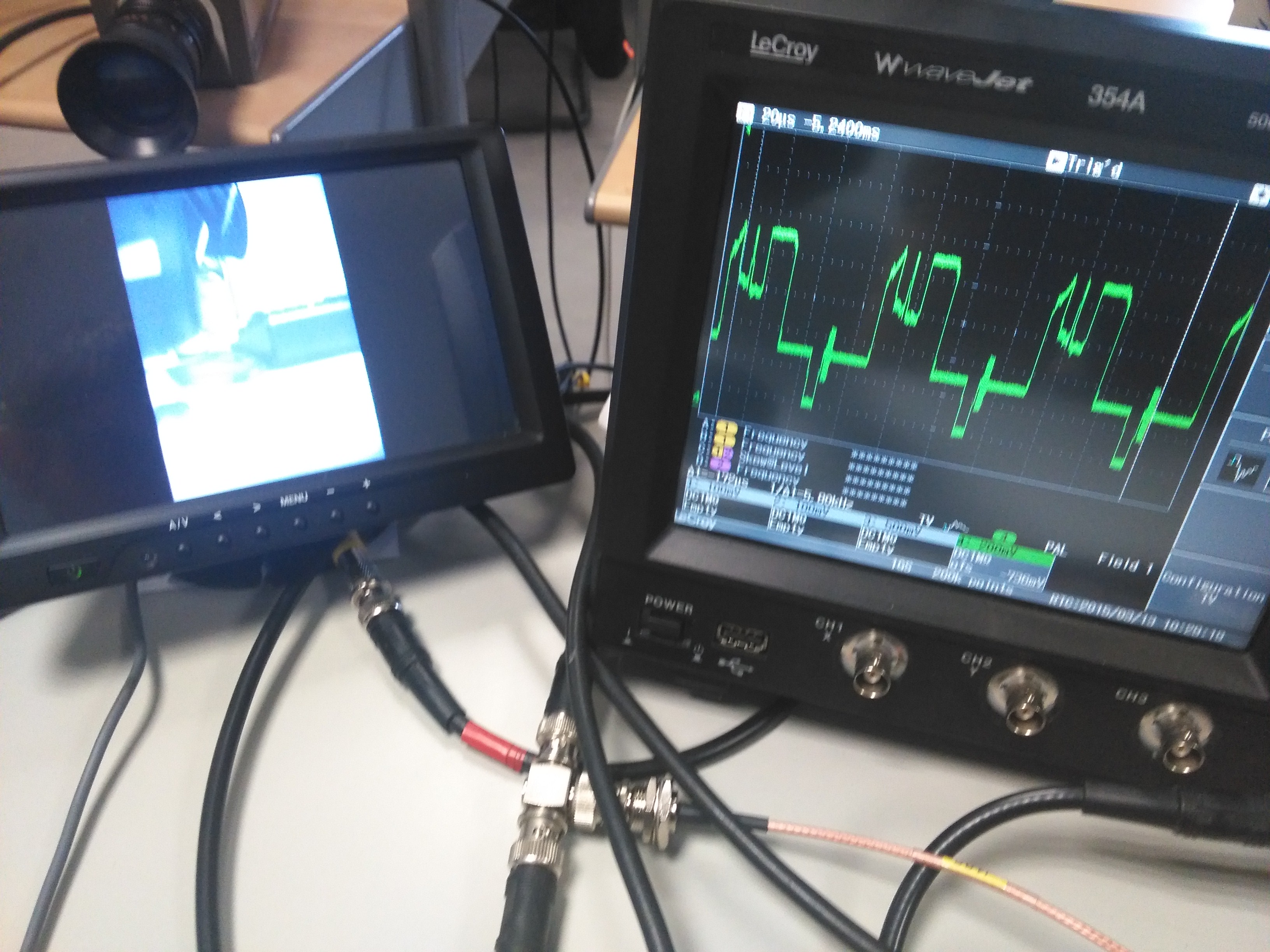

I use the DVRRDK 04.01.00.02 on a custom board with a DM8107
I try ti display video on VOUT0 port.
I finally managed to get a video stream on the output of the DM8107 VOUT0 making several changes in the sources of hdvpss and mcfw .
Now, I have another problem, in my monitor the larger of my video is divided by 2.
My usecase is simply this:
CaptureLink (PAL) -> DisplayLink (PAL).
In the HDVPPS (gSystem_dctrlTriDisplayConfig) , my setup is:
BP1_INPUT -> HDCOMP_MUX -> CIG_PIP_INPUT -> DVO2_BLEND.
As can be seen on the picture my image is halved.
Does someone could give me a idea of research to solve my problem ?
An the log:

  • This is that I do !!!
    I search similar issue but I dont found it !
    As we can see from the recorded signal on the oscilloscope, the image (payload) is not defined on a line but on half.
    I tried through a SWMS module and I added the white border.
    I see that the image is not cut but resize in width.
    The output that I use is the port VOUT0 of the DM8107 and is connected to an ADV7391 component.
    The signal is good since recognized by ADV, but the contained is invalid.
    My problem is that I can not know if the change ofthe width of the image is made in the hdvpss code or in LinkApi.
    What about you?
    A little help please !!

  • Hi Brijesh,
    I have add debug in displayLink ( *** DISPLAY).
    My usescase is currently : CAPTURE (1x720x576i50) -> DEI -> SWMS -> DISPLAY (1x720x576i50)
    I see in the log that I never happens in DisplayLink_drvSetResolution and DisplayLink_drvHandleDynamicPitch functions.
    I tried to force the call of the function DisplayLink_drvSetResolution with DISPLAY_LINK_CMD_CHANGE_RESOLUTION system link control, but none of my debug messages appear.
    In the log bellow, i don't understand the values of the pitch Y/C input / output. In don't resize the resolution therefore, these values should be identical.
    Ca you explain me this difference ?
    How is calculated the pitch size ?
    This is the log :

  • Hi Nocolas,
    Normal print statements does not come here, you need to Vps_printf statement to print the message to get them on the console. Please take the complete log from the start, it will be there once you use Vps_printf statement..
    rgds,
    Brijesh
  • I know it !
    It's that I do. I have no more information than what I posted.
    Can you explain the pitch values ?
  • ok, actually, there are not registers to check if frame size is configured correctly. Its all programmed in descriptor, from which it is difficult to know the frame size.
    Before this, can you dump the value at the offset 0x48100114? I want to check if the clocks are configured correctly in this registers.
    Rgds,Brijesh
  • Hi Brijesh,
    In the register 0x48100114, I read the value 0x0009010D.
    In the register 0x48100118, I read 0x0000000F.
    The HD_VENC_D_register :
    0x04810A000 : 0x5420305C
    0x04810A028 : 0x842716C0
    0x04810A030 : 0x805AA103
    0x04810A034 : 0x00000137
    0x04810A03C : 0x805A211E
    0x04810A040 : 0x00019000
    0x04810A044 : 0x00120150
    0x04810A048 0x02002120
    0x04810A04C : 0x02001142
    0x04810A050 :0x0013E13A
    0x04810A054 :0x805A2116
    0x04810A058 : 0x00018001
    0x04810A05C : 0x00120150
    0x04810A060 : 0x02001120
    0x04810A064 : 0x0200412B
    For me, all is correctly configured. The ITU's signals that are produced in DVO2 are good, but, it is the picture payload that is malformed.
    In the scope capture, the line duration is 64µs (normal) and the frame duration is 20 ms (720x576i50). All is good at this level.
    Where's the reduction factor by 2 ??? I'm searching in the sources code and datasheets, I do not find this information.
  • Hi Nicolas,
    Did you check the hdvpss patches from the below link? PAL mode is working fine with these patches on DVO2 output. Also can you try resetting bit16 at 0x48100114?
    e2e.ti.com/.../230439
    Rgds,Brijesh
  • When I reset the bit 16 at 0x048100114, the width seems good, but the video in not correctly displayed.
    There is a line dithering problem.
    See below :
    Regarding the patch you indicate, I based him to realize the change in my environment.
  • ok, it looks like timing information is still not correct, can you use timing information for the VENC from the link i shared.
    Also please make sure that the input pclk is configured to output 27MHz clock.
    Regards,Brijesh
  • Thanks,
    When You say configure the pclk to 27MHz, can you explain where I have to make the change ?
  • In vpshal_hdvenc.c, I use this configuration :
    {FVID2_STD_PAL, 1442, 576, FVID2_SF_INTERLACED, 27000, 25, 24, 134, 128, 2, 20, 2}, 4, 4, 4},
    The pclk used is already set to 27MHz... or is not the good.
    when I try to use the values that are in the patch
    {{FVID2_STD_PAL, 720, 576, FVID2_SF_INTERLACED, 27000, 30, 12, 68, 64, 2, 19, 3}, 4, 4, 4},
    the result is not good, the VOUT0 output signals are nor recognize by the video decoder ADV7391, then, the line duration is 32µs and the frame duration is 10 ms !!
  • Ok Brijesh, it s solved.
    I have apply in vpshal_hdvenc.c the values of the patch, and i have manually reset the bit 16 at 0x048100114.
    The resolution is good.
    Thank you for your patience
  • Glad to hear  it started working.
    Brijesh
