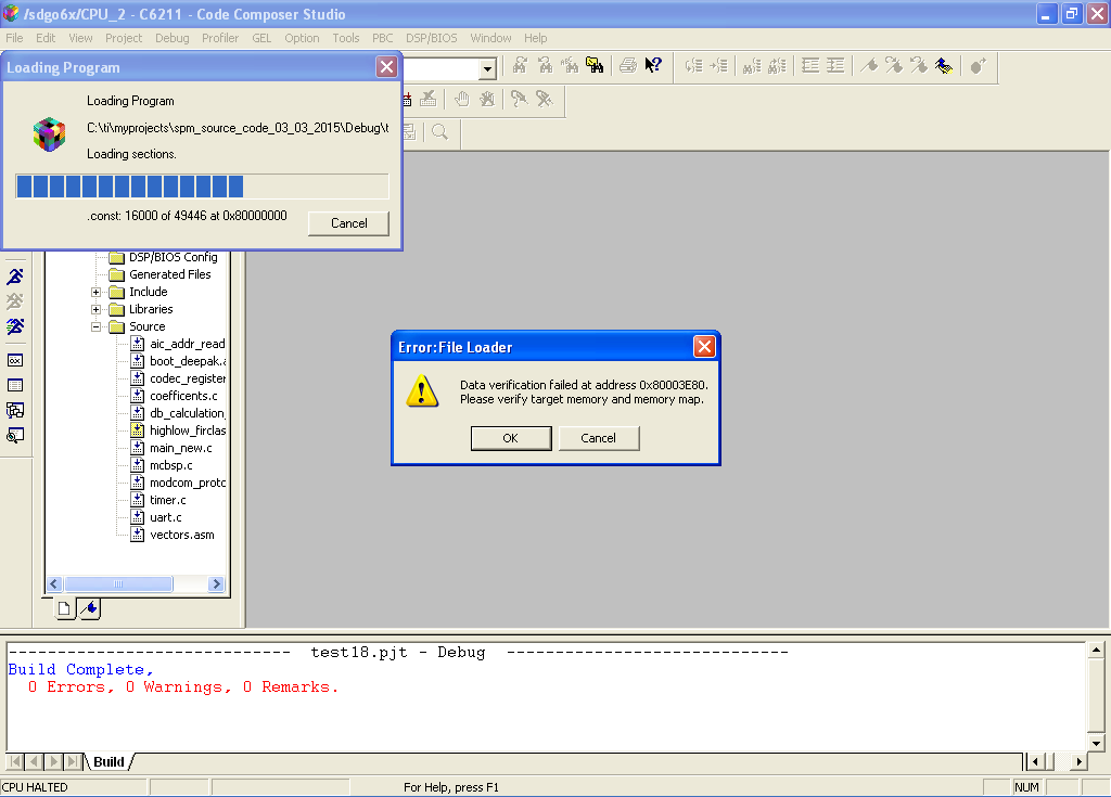

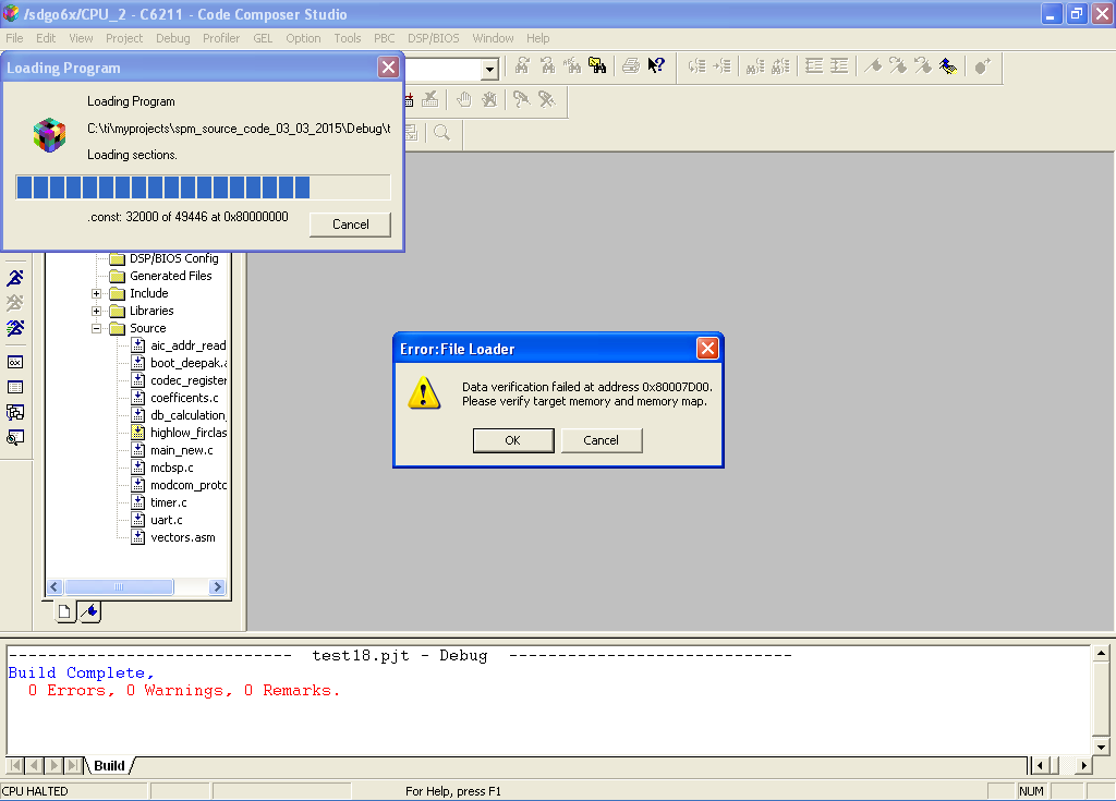

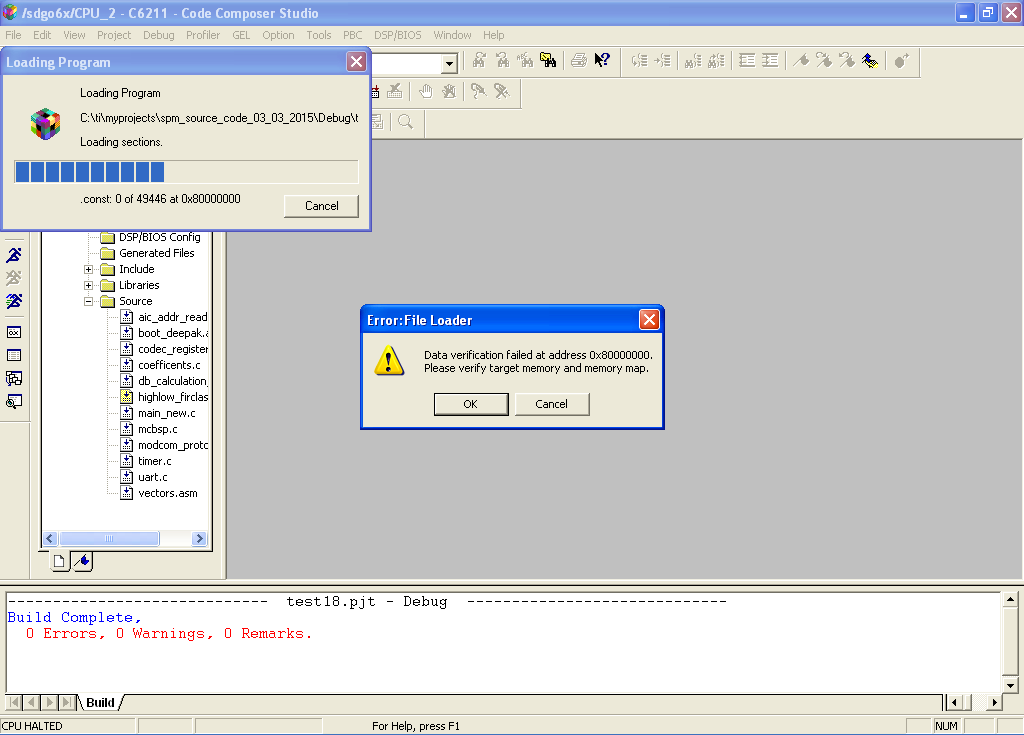

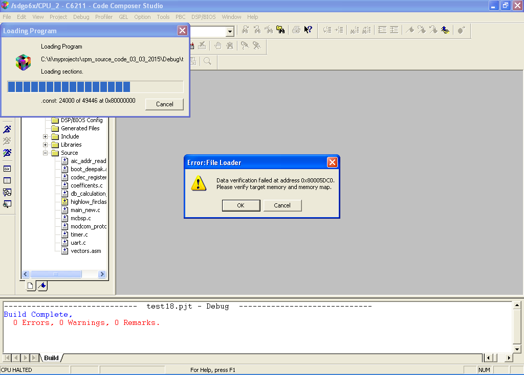

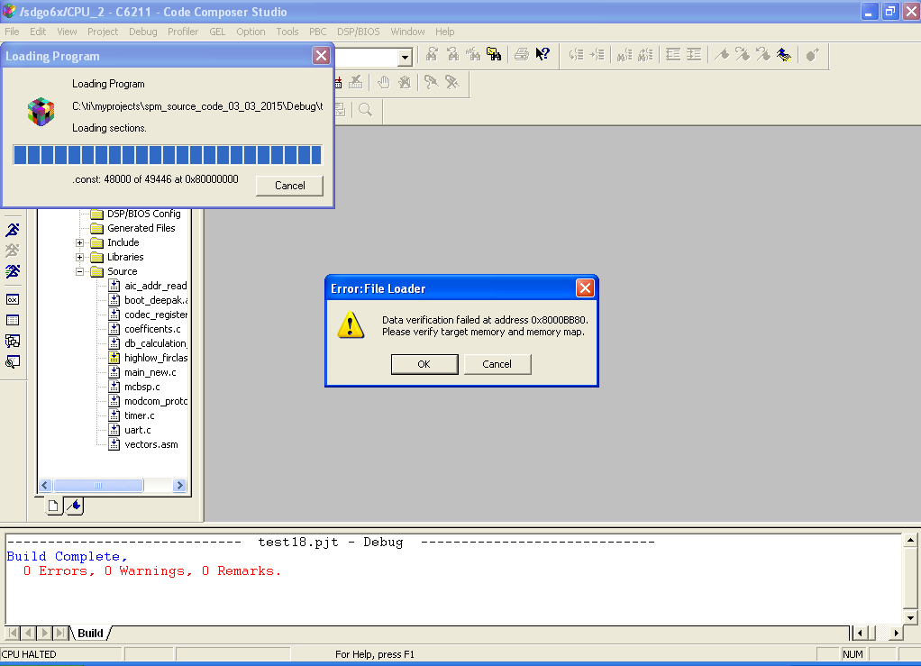

Program loading issue to 6211 DSP

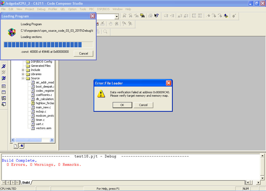

hai i am using 6211 based custom dsp board. In this interfaces the SDRAM. There are two booards with me. One is working fine. other has a problem when iam loading my project to the dsp, i get the following messages...
can anyone help me please?
  • Hi Rakesh,
    Able to connect emulator on problematic board ?
    Have you tried to use internal DSP RAM ?
    Shankari.
  • Hai sir,
    I can reset emulator. I can load other small programs. Here i interfaced SDRAM with DSP through EMIF.
    yes sir i am using internal RAM. But the program loading error message showing that problem in the SDRAM location 0x8000000. sir here i am attaching my .gel file and linker command file.

  • Hi Rakesh,
    I'm not able to see your attachments.
    Could you attach it again.
    Need to use "Use rich formatting" option to attach the files.
    Also I would like to suggest to attach the files like gel file, 'C' code etc., and please avoid text paste.
    Have you tried to run the simple program (LED) on SDRAM completely and not to use IRAM on both boards ?
    Able to access the SDRAM through CCS's memory browser after gel loaded ?
    Thanks for your understanding.
    Shankari.
  • hai sir,
    I can run simple led program on SDRAM. I can write to and read from SDRAM location.
    I can view the SDRAM location through CCS.
  • Hi Rakesh,
    If that's the case, then we need to look into hardware of the problematic board.
    Do you have anyother board ?
    Have you tried this code on the TI EVM board ?
    Shankari
  • Hai sir,
    In our board dsp and sn74lvth32374 are a BGA ICs. we have mounted the BGAs from outside and mounted the other components by our own. We mounted the components for two boards. One board is working fine. Other has problems. I checked the SDRAM signals for read and write for the boards. Both are showing the same.
    is this the problem with BGA IC mounting?
    in that case how this works for smaller programs?
    No sir , I don't have EVM board.
    thanks and regards,
    Rakesh T
  • Rakesh,
    Since you are using a very old version of CCS, I will not be able to tell you exactly how to do some of the commands using the features of CCS 3.
    The most likely cause of your problem, from my understanding of what you have said, is there there are addressing or data line or control line problems going to the SDRAM from the DSP. Since the verification failure occurs at many different locations, it could also be power supply noise or levels and it could also be bad memory devices.
    The quickest way to try to isolate the problem, if these guesses are correct, will be to try some of the following steps, after making sure the correct EMIF configuration steps have been taken which work well for the other board:
    1. Using the memory browser or menu commands, fill memory with all 0's, then scroll through the memory window looking for a 1 in any bit. Or try filling with all F's and scroll looking for a 0 in any bit.
    2. After attempting to load your program, use the memory browser to go to the address where the verification error occurred. You can use your .map file and your source code and your listing files (.lst) to find out what value should be at that location and view it in the memory browser to see what value was written. Try to manually write the correct value there in the memory browser window and see if you are able to write the correct value or not. You can also try comparing with the values that are loaded correctly on the other board, which might be easier than looking through all those files.
    3. Write a test program that only resides in IRAM and have that test program write all 0's, then all F's, then an incrementing pattern, then the inverse of that incrementing pattern, and check the results using the program after each fill of SDRAM. If there are problems with writing to the SDRAM, this should find them.
    RandyP
