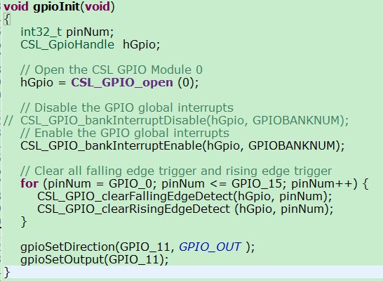

Hi,all!
I have met a problem: when I use CSL_GPIO_setOutputData() function in SYS/BIOS,this function does'nt work.But if not use SYS/BIOS,this funion does work.So I wonder whether csl function can use in SYS.BIOS or not.Is it possible that the initialization is wrong?I use GPIO11 as output.The code is as below:
In addtion,I want to know the main difference between ***.h and ***Aux.h.
For example,csl_gpio.h and csl_gpioAux.h.
I have read the note of csl_gpio.h as"This is the main Header File for the GPIO Module which defines all the data structures and exported API.".
and the csl_gpioAux.h as" This is the GPIO Auxilary Header File which exposes the various CSL Functional Layer API's to configure the GPIO Module.".
But I really don't know what the word 'Aux'exactly mean.Hope for your help!
Many thanks!
TMS320C6678
ccs 5.2
bios 6_33_05_46
pdk_C6678_1_0_0_18

    Thanks for your update. As per your cfg file you did not import the CSL packages. For my understanding, CSL packages are not imported means, the SYSBIOS will not support the CSL functions.
    /* Load and use the CSL packages */
    var cslSettings = xdc.useModule ('ti.csl.Settings');
