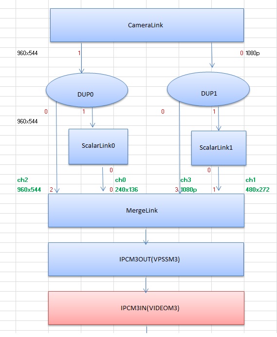

Hi All,
S/W : IPNC RDK V3.8
Platform : DM388
My requirement is to  capture 1080p and to get 4 different resolutions (1920x1088,960x544,480x272,240x136) simultaneously without any time drift between them .
I am using the VIP resizers and two scaler links  to achieve this. See the usecase diagram below
However, I am not able to synch  all channels together, since the output of scalers arrive late . See the log below
[m3video] pFrame->channelNum = 2  time = 8309

Because of this problem, I am getting only 15 fps after synching. I am able to achieve 30 fps  with one scaler ( 3 channels).
Is there a way to fix this issue? Are there any other links, which can scale faster  than the scaler link ? I tried DEI link also, but of no use.

  • Attached the usecase  diagram
  • Hi JK,
    All the scalars in the HDVPSS work at the same speed, so even if you change the scalar, it wont help much.
    But each scalar will be able to scalar 1080p stream at 30fps, so it might be delayed, but you should be able to get 30fps output.
    Regards,Brijesh
  • Hi  Brijesh,
    I am getting full 30 fps for all  the 4 channels. That's not the issue. Issue  is the delay between the scaler and VIP resizer.
    When there is only 1 scaler( 3 channel  usecase)  the delay between them is about 6-7 msec. But when there are 2 scalers, the second scaler is delayed  by almost  2 times the previous delay (12-14 msec) , hence I am missing the synch often.

    Is there any way to reduce  the delay ? By the way, what is the max number of scaler links, that I can use?

  • Hello JK,
    What matters is, you use different scalars for both the inputs. If you use scalar, second scaling operation will be delayed, There is some parameter in the scalar create time, where you could specify scalar to be used. Please use different scalars here.
    Brijesh
  • Hi Brijesh
    What you mean by using different scalars? I am using two instances of sclrLink now. Do you mean, to use sclrLink for one input and another link say deiLink for the other input? I have already tried this.
    What is the create time parameter you mentioned? pathId ?
    Best regards
    JK
  • there are multiple hardware scalar instances, so you should use different hardware scalar instances for each scalar link.
    Can you check if you are using SC5? If it is the case, you could use SC3/4 for the second instances.
    Regards,BRijesh
  • I am using SC3 & SC4
  • When I use SC5 for first instance and SC3 for second instance, scalar creation is  not  successful.
    See  the log  below

  • SC3 and SC5 cannot be used at the same time. Use SC4 instead, with SC5.Regards,

  • SC5 & SC4 causes the below assert
    [m3vpss ] 7443: CAMERA: Create Done !!!
    [m3vpss ] 7535: CAMERA: Detect video in progress !!!
    [m3vpss ] 7536: CAMERA: Detect video Done !!!
    [m3vpss ] DCC server task running
    [m3vpss ] 7738: DUP : Create Done !!!
    [m3vpss ] 7753: DUP : Create Done !!!
    [m3vpss ] 7753: SCLR: Create in progress !!!
    [m3vpss ] 7570: Assertion @ Line: 646 in core/src/vpscore_secPath.c: (NULL != instObj) : failed !!!
    The params are :

  • Can you see if SC1/2 be used?
  • In sclrLink.h , I can see only 3 cases as below
    #define SCLR_LINK_SC5 0
    #define SCLR_LINK_SEC0_SC3 1
    #define SCLR_LINK_SEC1_SC4 2
    No SC1 or SC2.
  • oh ok, in this case, we have to use one of these scalar only.
    Can you try using SC5 alone for the scalar link and see how the latency look?
    Regards,Brijesh

  • Hi Brijesh,
    SC5 create is success , when outDataFormat is VF_YUV422I_YUYV, but fails when outDataFormat is VF_YUV420SP_UV.
    I have to use VF_YUV420SP_UV. Is this NOT supported on SC5 ?
  • Hi JK,
    SC5 supports only YUV422 output , does not support YUV420 output. If you want YUV420 output, you need to use either SC3 or SC4.
    Can you tell me which DVR-RDK release that you are using? SC3/SC4 should work as it is. there should not be any assertion.
    Are you using SD Display? SD display can use the path that SC4 is using.. If this is the case, we are left with only one option, sc3.
    Brijesh
  • Hi Brijesh,
    I am using IPNC RDK Ver 3.8 on dm388. I am not using SD display. I just wanted to have 4 resolutions (1920x1088/960x544/480x272/240x136) @30fps with max delay of 7 msec. With 1 scalar (3 resolutions) I have no problem. But when add one more scaler, the delay is too much to handle. So I understand all VPSS based resizers will have the same problem (SwMs, Mp scaler,DEI,etc). Am I correct? Is there a way to reduce this delay when multiple scalars are used?
    JK
  • Hi JK,
    From the ISS itself, you will be able to get 2 resolutions, now you require two more resolution, If use of two scalars is causing some latency issue, why dont you use just one scalar and get both the remaining resolution. from 1920x1088, it will be difficult to get the remaining resolution in time, so use lower resolution lets say from 960x544, you will be able to get other two resolutions using same scalar (two instances of scalar link).
    Rgds,Brijesh
  • Hi Brijesh
    I have a doubt. By using 1 scalar and two instances, do you  mean  to use  the same pathId ?  Pls check the below code is correct or not.
     /* Scaler Link Params */
        SclrLink_CreateParams_Init(&sclrPrm[0]);
        sclrPrm[0].inQueParams.prevLinkId             = dupId;
        sclrPrm[0].inQueParams.prevLinkQueId          = 1;
        sclrPrm[0].outQueParams.nextLink              = mergeId[CAM_STREAM_MERGE_IDX];
        sclrPrm[0].tilerEnable                        = FALSE;
        sclrPrm[0].enableLineSkipSc                   = FALSE;
        sclrPrm[0].inputFrameRate                     = 30;
        sclrPrm[0].outputFrameRate                    = 30;
        sclrPrm[0].scaleMode                          = DEI_SCALE_MODE_ABSOLUTE;
     sclrPrm[0].outScaleFactor.absoluteResolution.outWidth   = 240;
        sclrPrm[0].outScaleFactor.absoluteResolution.outHeight  = 136;
        sclrPrm[0].outDataFormat = VF_YUV420SP_UV;
        sclrPrm[0].pathId = SCLR_LINK_SEC0_SC3;
     SclrLink_CreateParams_Init(&sclrPrm[1]);
        sclrPrm[1].inQueParams.prevLinkId             = dupId;
        sclrPrm[1].inQueParams.prevLinkQueId          = 0;
        sclrPrm[1].outQueParams.nextLink              = mergeId[CAM_STREAM_MERGE_IDX];
        sclrPrm[1].tilerEnable                        = FALSE;
        sclrPrm[1].enableLineSkipSc                   = FALSE;
        sclrPrm[1].inputFrameRate                     = 30;
        sclrPrm[1].outputFrameRate                    = 30;
        sclrPrm[1].scaleMode                          = DEI_SCALE_MODE_ABSOLUTE;
     sclrPrm[1].outScaleFactor.absoluteResolution.outWidth   = 480;
        sclrPrm[1].outScaleFactor.absoluteResolution.outHeight  = 272;
        sclrPrm[1].outDataFormat = VF_YUV420SP_UV;
        sclrPrm[1].pathId = SCLR_LINK_SEC0_SC3;
    Best regards
    JK
  • Yes, Path Id is same, but two instances of scalar link
    Your all resolutions are down scaled by 2 from previous one.
    Can you use below linkISS Capture --> (1920x1088, RSZA)
    --> (960x544, RSZB) -> (Scalar Link1, 480x272) -> (Scalar Link2, 240x136) -> Your Merge Link.
    Regards,Brijesh
  • Hi Brijesh
    There is little  improvement with the suggested usecase. But my core issue remain unsolved. Even after  synching all  4 channels  and  ensuring that yuv frames  arrive  at codecSubmitData()  at 30fps rate, there is  still   OutBuf  Not available  error, and because of this, half  of the frames /second are dropped, effectively making the fps= 15.
    my sync logic  is  as follows.
     do
      svcEncLink_codecQueueFramesToChQue(pObj);
     }while(!((pObj->chObj[0].inFrameQueCount > 0) && (pObj->chObj[1].inFrameQueCount > 0)  && (pObj->chObj[2].inFrameQueCount > 0)  && (pObj->chObj[3].inFrameQueCount > 0) ) );
    svcEncLink_codecSubmitData(pObj);
    While, this logic worked well  for 3 channels, don't know  why it causes frame drop with 4 channels.
    Best Regards
    JK
  • Are you allocating enough buffers?Rgds,Brijesh
  • Yes, Brijesh. I guess  buffers  are not the problem. When the delay increases, there are more frame drops  from codecSubmitData(). I verified this by adding extra delay, and observed that there are more "outBuf not available"  and subsequent frame drops.
     do
    for (i=0;i<240000;i++) {}; //delay
    There  was  a similar problem (In a different context) discussed  here.
    I too had  the same issue, and got it resolved by using Anand's uImage.
    Back here, I have  ensured  that  the ipcBitsInLink is active  and A8 load  is  below 50%.
    Still  not  able  to correlate all these.
    Best Regards
    JK
  • Hi Brijesh
    The issue is fixed. I changed the sync logic a bit, considering the fact that resizer outputs arrive before the scalar. No frame drops now.
    Thanks for your help & suggestions.
    Best regards
    JK
