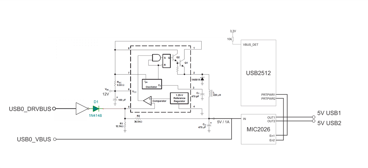

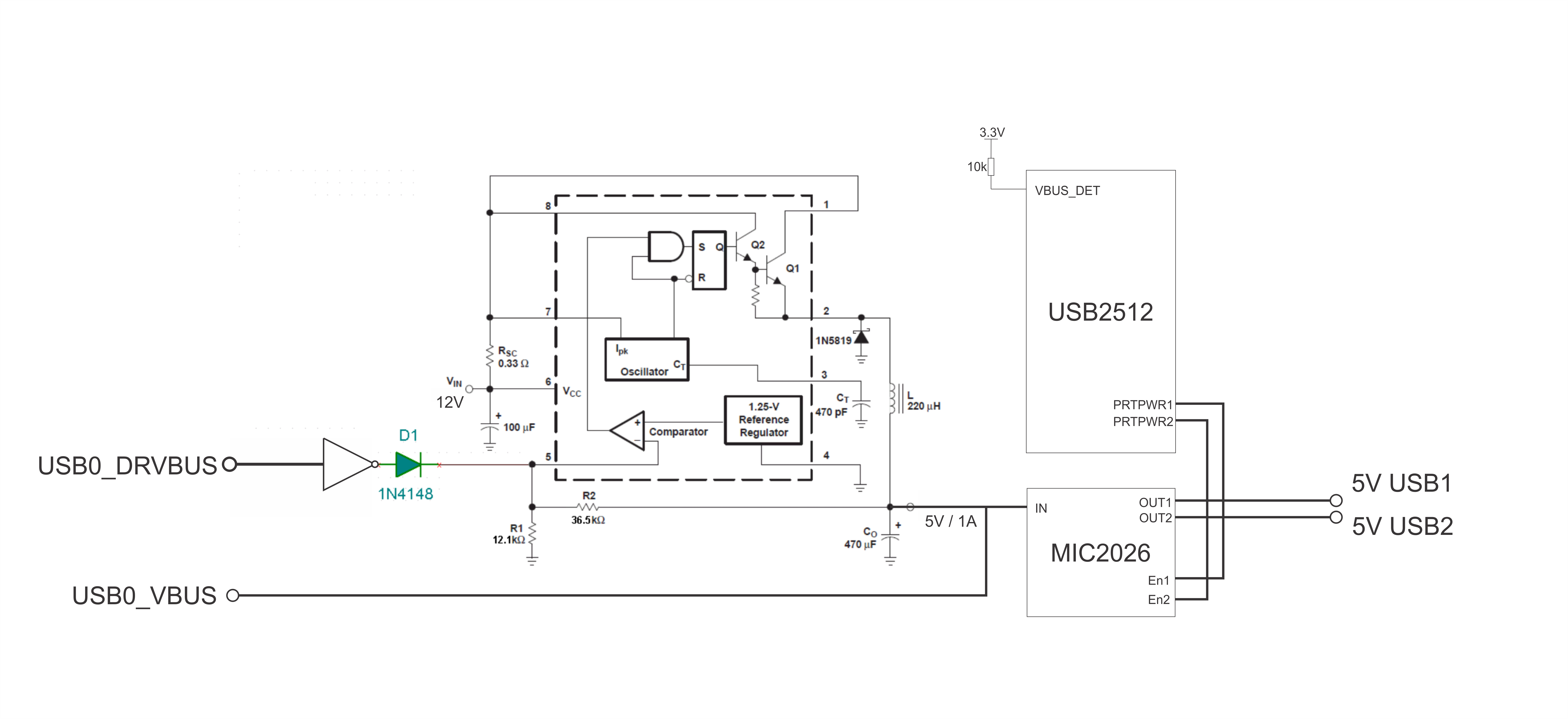

  • Thank you very much, I checked the Wiki page. In datasheet of USB2512 I found that "For self powered applications with a permanently attached host, VBUS_DET pin must be connected to 3.3V". I'm planing to use MC33064 to generate 5V for USB port power. I made circuit to enable/disable power supply with MC34063. In that case I will do next:
    1) Connect AM3352_USB0_DRVBUS to the Enable disable pin of MC340633 circuit.
    2) Connect OUTPUT of MC34063 circuit to the AM3352_USB0_VBUS and to the input of MIC2026_INPUT.
    3) USB2512_VBUS_DET is connected via 10k resistor to the 3.3V as is suggested in datasheet.
    4) USB2512_DRVBUS pins are used to control MIC2026 OUTPUTS and to enable or disable BUS power.
    I attached simple block diagram to explain my idea.
    Please correct me if I'm wrong.
    Best regards.

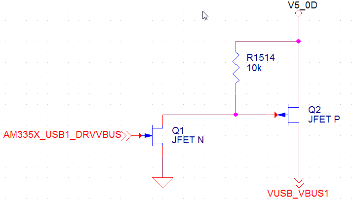

  • I'm not sure how the USB0_DRVVBUS circuit will work. USB0_DRVVBUS is active high, with high level 1.8V or 3.3V, depending on VDDSHV6 voltage used. Also I'm not sure what the MC340633 ramp-up/down time is. As an alternative you could have it always turned on and use a simple circuit like this:
  • OK, I agree with you, because it is DC/DC converter its need some time to stabilize. The idea which you gave me is better than go to directly from MC34063 to the USB_VBUS.
