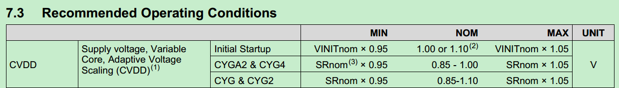

DM8168 CCYG4's AVS voltage normal is 1.00V,do I need to modify avs driver?
Jus as the doc SPRS614E says,the recommended avs voltage for DM8168 CYG4 version is 0.85V~1.00V.
So,do I need to modify the corresponding AVS driver for the max limit?
And,on the table,SRnom,and notes in the doc:is unique for every device.How can I read the SRnom?from which register?I did not find it in the datasheet.
