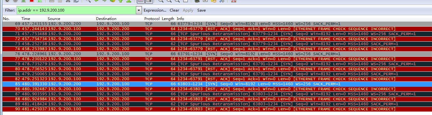

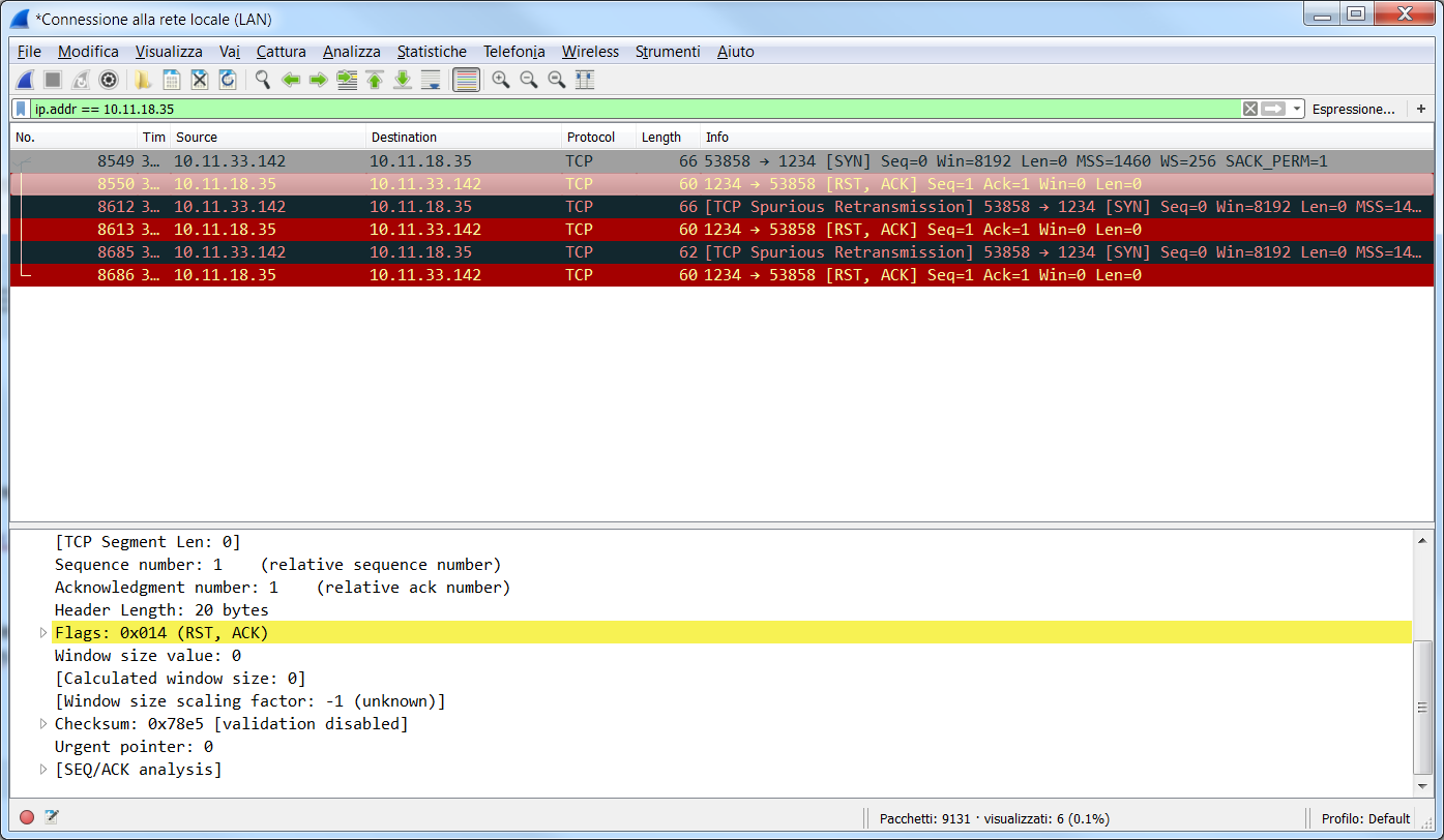

Hi, all
When I use the UIA in my project, combine the project(http://processors.wiki.ti.com/index.php/TMS320C6678L_Build_Configuration) with my own. I want to transport data via NDK, it doesn’t work. Every time I start to debug the project, A "System Analyzer Welcome" view can open automatically. I can connect the board with telnet, after running the System Analyzer, nothing comes out. I check the tcp connet with wireshark.
PC connect the 6678 in port 1234 with SYN, but the 6678 reply RST. TCP connect fail.
I have try it for a long time, please help me.

    I have tried the UIA project alone. The tcp with port 1234 connect can set up. But in SA window, nothing comes out. But in JTAG mode(processors.wiki.ti.com/.../SystemAnalyzerTutorial1F) , the data comes out correct.
    You mean, able to get expected output (pinging the IP address and verified on wireshark capture) with UIA project alone when you run with JTAG mode (CCS) right ?
    When I use the UIA in my project, combine the project(processors.wiki.ti.com/.../TMS320C6678L_Build_Configuration) with my own. I want to transport data via NDK, it doesn’t work. Every time I start to debug the project, A "System Analyzer Welcome" view can open automatically. I can connect the board with telnet, after running the System Analyzer, nothing comes out. I check the tcp connet with wireshark.
    You mean, not able to get expected output (pinging the IP address and verified on wireshark capture) even when you work with JTAG mode (CCS) right ?
    Could you provide me the exact link (examples) that you are working.

  • Hi!
    I've got the same issues.
    First of all, all those "ethernet frame check sequence incorrect" errors are related to a bug in NIMU drivers;
    Please take a look here: http://e2e.ti.com/support/dsp/davinci_digital_media_processors/f/99/p/288506/1011979#pi317334=2
    Beside that, I've followed this guide to use UIA with ethernet transport (via NDK): processors.wiki.ti.com/.../System_Analyzer_Tutorial_3B
    When I click on the "Run" icon in Live session view, I get this:
    Code composer and the target cpu try a couple of times to estabilish a connection, but ethernet packets have problems both ways.
