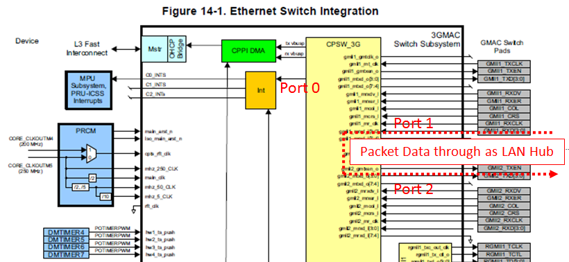

I want to achieve the LAN hub function with 2 ethernet ports on the AM3352 Ethernet Subsystem.
I think possible because the 3PSW supports a Layer 2 switching, Can I use the 3PSW as follows?
When the packet data come into ether port 1, this packet data is moving through to ether port2 without CPU and/or DMA intervention.

  • That is exactly the purpose of the ethernet switch subsystem.
    Minimal initialization is the same as for a single ethernet port, except with port-specific steps repeated for both ports. I described it in somewhat more detail for the dm814x in this post (the am335x is essentially the same except for its clock config).

  • The linux driver for the ethernet subsystem is contained in the sources drivers/net/ethernet/ti/cpsw*. It operates in switch mode by default. (Alternatively you can set the "dual_emac" property in device tree to request the two ethernet ports to appear as separate network interfaces.)
    Note however that for basic (unmanaged, vlan-unaware) switch functionality no driver would be required to look after the switch and PHYs after initialization. I have a baremetal codebase which just performs the initialization during early startup and pays no further attention to the switch, and it works fine. An ethernet driver for the host (involving only the CPDMA and CPSW_WR registers) can be started (and restarted) at any time after that without affecting the switch. There is a minor issue that switch table entries would never age out, so the switch table might fill up over time, but this would only become a problem if the switch encounters 1024 distinct network devices since it was last reset, which is not very likely on most networks. I'm also not sure whether anything bad would actually happen.
    Note that the linux driver isn't structured this way: the switch initialization/driver and host ethernet driver are interwoven there. (In particular, with the current state of the linux driver you can't reboot the host without also resetting the switch.)
    FYI, the term "hub" refers to a somewhat different kind of device which operates purely at the physical layer and is unaware of network addressing. It is mostly obsolete, having been displaced by switches.
