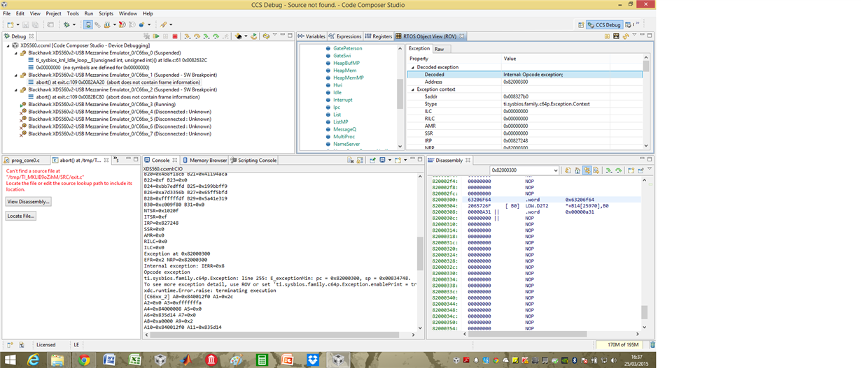

  • hi,
    I was looking for and found one way to see the problem.
    I have the print screen and you can see. But can you help me?what i need to do and solve this bug?
  • I did not see and code on you screen shot, I am not able to help you with out your test code.

  • Hi
    i´ve looking for someething in asm code and I found this:
    in core 1 error accur here
    messageQ = MessageQ_create("CORE0", NULL);
    if (messageQ == NULL)
    System_abort("MessageQ_create failed\n" );
    [C66xx_1] ti.sysbios.family.c64p.Exception: line 255: E_exceptionMin: pc = 0x82000300, sp = 0x00834758.
    asm code
    82000300: 63206F64 .word 0x63206f64
    82000304: 2065726F [ B0] LDW.D2T2 *+B14[25970],B0
    82000308: 00000A31 || .word 0x00000a31
    in core 2 the error accur here
    messageQ = MessageQ_create("CORE1", NULL);
    [C66xx_2] ti.sysbios.family.c64p.Exception: line 255: E_exceptionMin: pc = 0x84800300, sp = 0x00835cd8.
    asm code
    84000300: 63206F64 .word 0x63206f64
    84000304: 2065726F [ B0] LDW.D2T2 *+B14[25970],B0
    84000308: 00000A32 || .word 0x00000a32
    so, is this .word would be the core name?
    Unttil now i can´t find out one solution.
