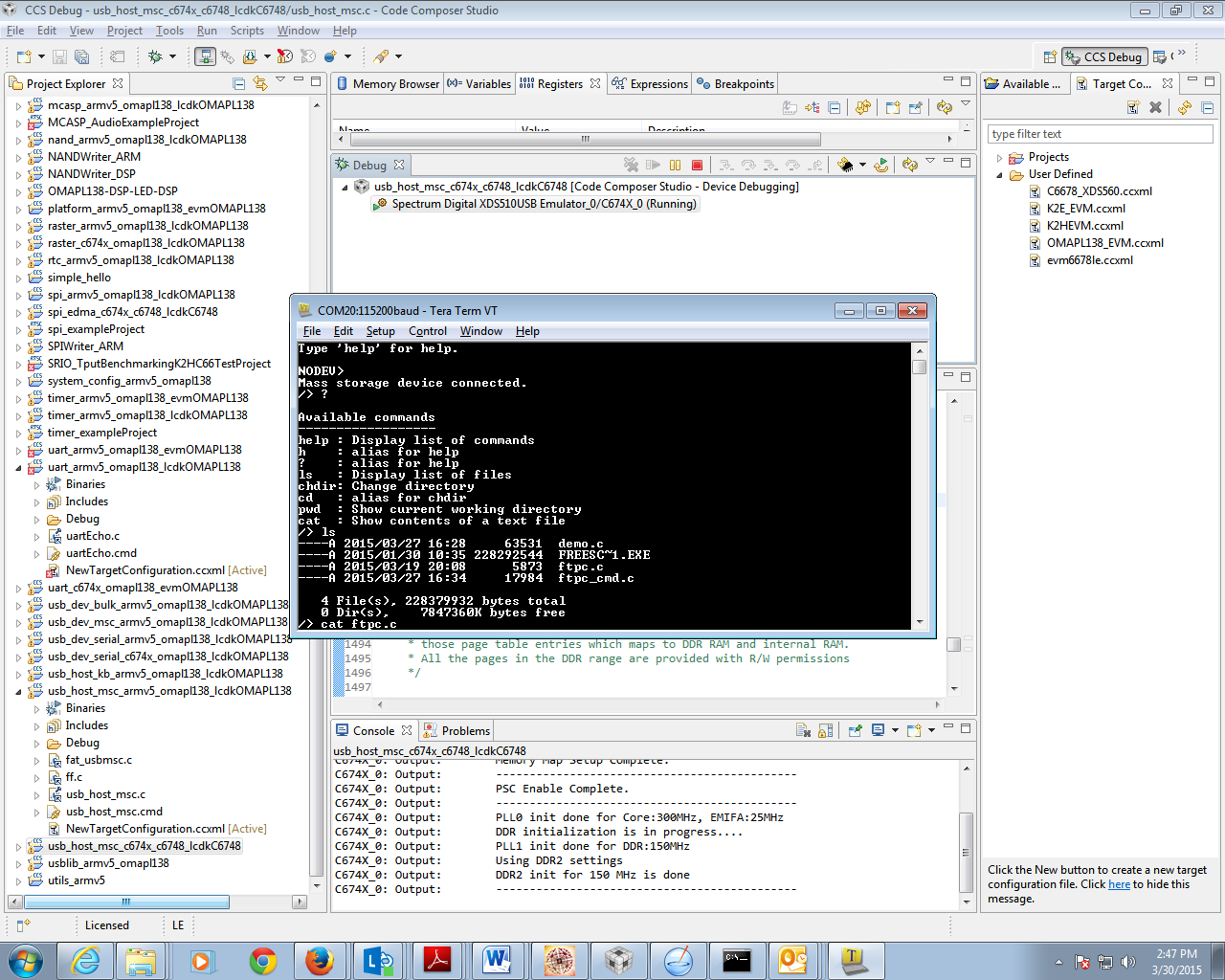

    2. Using CCS, please import the example, USB_host_msc which is part of C6748 Starterware package. ( path : C:\ti\C6748_StarterWare_1_20_04_01\build\c674x\cgt_ccs\c6748\lcdkC6748\usb_host_msc
    3. Refer the screenshot below to know the comands available in that example. Using "cat" command, you can read a file and display it on the debug window.
    4. There are no commands available for transferring files to and from the pen drive into the DSP. You can view the files, list the files and display the files.
    5. please note that the "ls"command works fine in the screenshot below.
    Please revert if have any questions in running the USB host Msc example.
