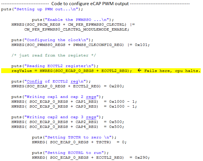

We are trying to configure the eCAP module to generate a PWM output signal on ECAP0_IN_PWM0_OUT.
When the ECCLT2_REG value is read, the CPU halts.
Any ideas why simply reading this register causes the CPU to halt? Does this mean a peripheral isn't correctly enabled or a clock that isn't turned on?
Here is the code run from u-boot:
Is there anything missing from this code, such as missing configuration steps?

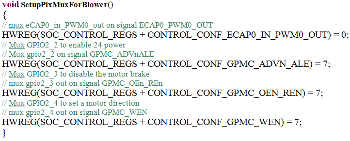

Additionally, here is the current mux configuration, which is also done in u-boot:
Is this the correct way to mux the pins for the eCAP module?
