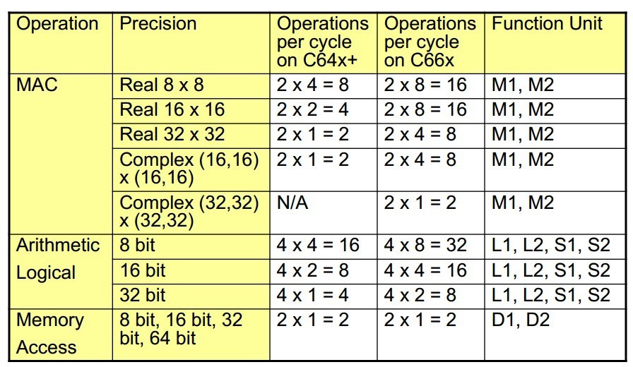

   How many multiply  operation can C6678 done in a cycle?
  I found a table in a document,here it is
does it means that in a single clock cycle C6678 can do 64 times 32bit x32bit operation?
thus, 100*100 Matrix Multiple is about 1,000,000 times multiple operation .then it means that It cost at least 1,000,000/64 = 15625 cycle?
