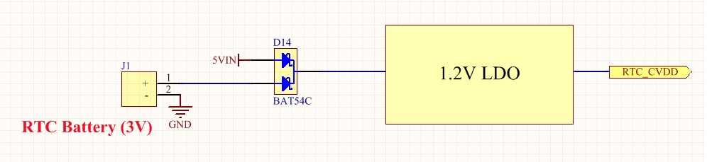

    Our design contains a battery and a 1.2V LDO working together. If the board powered up with system voltage (5V) the LDO is working, so the battery's life time does not finish. Below picture.
    I checked the power sequence of my board. The RTC_CVDD wake up after the CVDD (1.2V) and before the DVDD (1.8V). So when I forgot to using battery the power sequence was wrong. Now I correct the sequence but the problem is continue (permanant damage).
    The wrong squence can cause the problem ?

    I would like you to go through the power on sequence given in section 6.3.1 in the device data manual.
    RTC (RTC_CVDD) may be powered from an external device (such as a battery) prior to all other supplies being applied or powered-up at the same time as CVDD. If the RTC is not used, RTC_CVDD should be connected to CVDD. RTC_CVDD should not be left unpowered while CVDD is powered.
    When you forgot to connect the battery, the power sequence was wrong. This would have affect the device functionality. We strongly recommend you to follow the proper power sequence to get the device functions normally and reliably.
