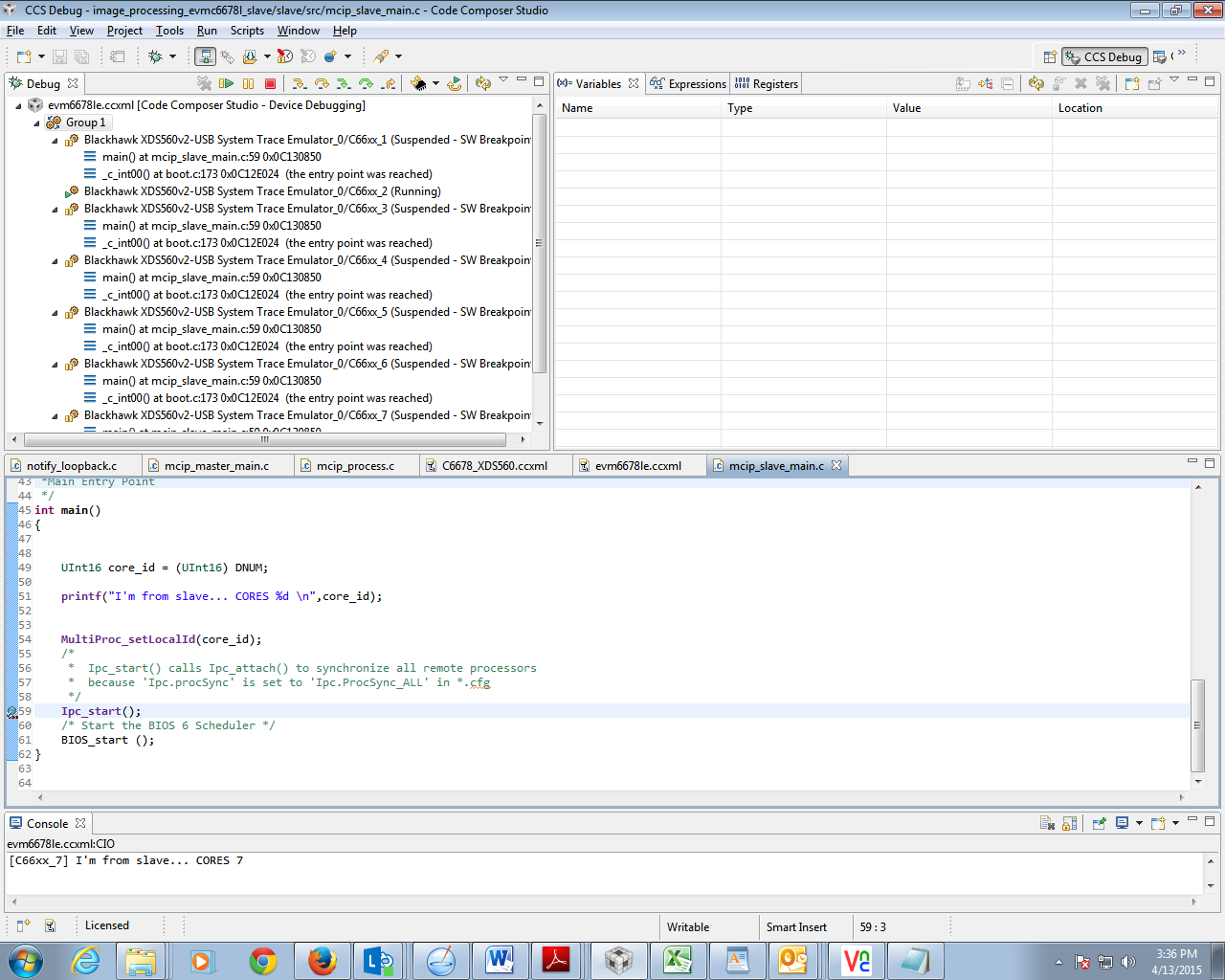

Cannot perform the Ipc_start() successfully when I debug the project
Other Parts Discussed in Thread: SYSBIOS
When I debug the project ,I make a breakpoint at the statement  which  follows the Ipc_start(), that means  that I cannot get the return value of the Ipc_star(),
In my c file ,I cannot get the value of status.
what are the possible reasons causing the problems, how can I slove the problem?
thank  you
Int main(Int argc, Char* argv[]) { Int status; /* * Ipc_start() ca+]lls Ipc_attach() to synchronize all remote processors * because 'Ipc.procSync' is set to 'Ipc.ProcSync_ALL' in *.cfg */ #if 1 status = Ipc_start(); printf("%d\n",status); if (status < 0) { System_abort("Ipc_start failed\n"); } #endif BIOS_start(); return (0); } /* * @(#) ti.sdo.ipc.examples.multicore.evm667x; 1, 0, 0, 0,1; 5-22-2012 16:36:06; /db/vtree/library/trees/ipc/ipc-h32/src/ xlibrary */

  • Do you this behavior with example project provided by TI or own project? We recommend you to test the TI provided MCSDK examples to start with. Thank you.
  • Able to get expected results if you didn't set breakpoint ?
    What is the value of "status" variable ?
    What example are you using ?

  • if I don't set the breakpoint ,I also cannot get the value ,the project is built by me . I want to konw  what possible reasons causing the problem,
  • Hi hui,
    Please give the following details so that we will try to reproduce it from our end and help you out to set break point at the functions appropriately.
    1. Version details of IPC package and the name of the example program of IPC.
    2. On which TI EVM, you experiment this?
    Shankari
  • Hi ShanKari
    when I test the example ,the Ipc_start() function is good, the following is my c file and cfg file,
    can you give me a help?
    thank you

  • Hi Hui zhu57,
    hui zhu57 says said:
    1、 the version of the IPC package are ipc_1_23_05_40 and ipc_1_24_03_32, the name of the example program of IPC is C6678:MessageQ(single image for all cores).
    2、TMDXEVM6678LE
    I tried out the image processing demo example for EVMC6678 with the IPC package version 1_24_03_32 and ipc_1_23_05_40.
    Able to stop with the breakpoint at function, main(). Please refer the screenshot below. Actually your project seems to have some problems in using the ipc packages. I would recommend you to run this demo example and see you are able to stop at main(). If it works, compare the CCS properties of the demo project with your own project.
    I suspect the way you run the program
    As mentioned in comment, "Ipc_start" would return when all the slave cores get loaded with appropriate binaries (.out).
    MultiProc.setConfig(null, ["CORE0", "CORE1", "CORE2", "CORE3", "CORE4", "CORE5", "CORE6", "CORE7"]);
    /* Synchronize all processors (this will be done in Ipc_start) */
    Ipc.procSync = Ipc.ProcSync_ALL;
    Say, For example, In *.cfg, if you mention that SYNC is required for 7 slave cores then you may have to load the slave's .out into 7 cores.
    Please refer to the following TI wiki page to know more about IPC sync.
    http://processors.wiki.ti.com/index.php/IPC_Users_Guide/Ipc_Module#Ipc_Module_Configuration
    Shankari
    Please click the Verify Answer button on this post if it answers your question.
